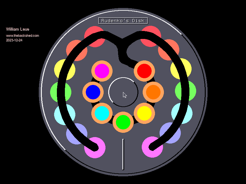

Here's another puzzle for you: Rudenko's Disk.
Rudenko.zip
(Requires a mouse, sorry!)
Enjoy!
-Bill
