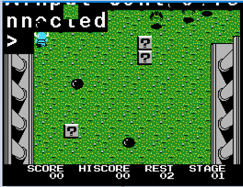

Unfortunately, running Knightmare on this MMB4W version ends in a crash. I don't know if the Wine implementation of the direct input is not stable enough.
Unhandled exception: page fault on read access to 0x00000000 in 32-bit code (0x6dd5c860).

Posted: 03:13am 24 Feb 2024
Hi Peter, the Xbox controller works well in Leo's knightmare game but when it announces that the controller is connected the game has already started and it overwrites the game's screen and doesn't go away. So the game must be restarted.
I guess there are work arounds but maybe if it didn't print the message and set an MM.INFO flag so that the programmer could check that and take the appropriate action that might make life easier.
