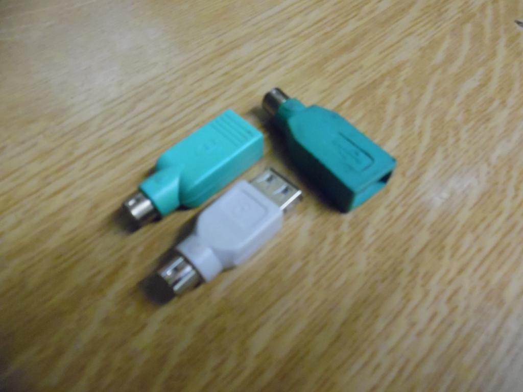

I found these old usb  to ps2 adaptors for old pc but could the ps2 work with picomite?
I don't have any ps2 connectors to check wiring but I could use a tapometer to see what's inside the adaptor.

Posted: 10:01pm 21 Dec 2023
AFAIK they are just pin-pin connectors. A lot of USB keyboards (especially the older ones) will also work with PS2 inputs using one of those.
Those are the adapters you keep in a drawer for ten years, throw away then need one urgently.
Posts: 3417
Posted: 10:10pm 21 Dec 2023
Usually those adapters just connect PS/2 pins straight through to the USB pins.
They only work for keyboards and mice that can automatically switch between PS/2  and USB modes. They test the port at power up and select the mode depending on what data they see.
Edit. Too slow!
Edited 2023-12-22 08:12 by phil99

Posted: 10:57pm 21 Dec 2023
Yes there is no protocol conversion going on in that little connector. It relies on the keyboard having the smarts to know which protocol to send.

Posted: 11:07pm 21 Dec 2023
Yepp I use them all the time with my Cherry Keyboars, since I have no PS/2 ONLY keyboard. The keyboard you use MUST support PS/2.

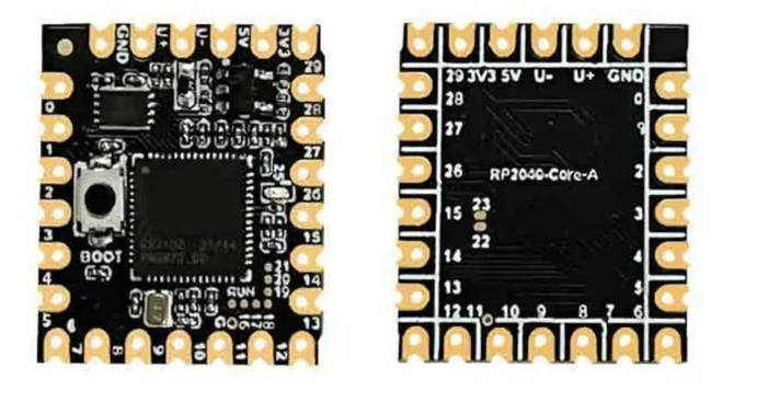

Posted: 02:59pm 22 Dec 2023
Here is one project using pico
ps2pico
could be a good use of the WS RP2040 Zero mini board.
or the RP2040 Stamp might be the smallest way.
updated version using level shifter and doing both keyboard and mouse
ps2x2pico
and one using STM32
usb2ps2conv
I have box of Blue pills not sure if the can be used here.

Posted: 10:45pm 22 Dec 2023
I've looked at the Stamp before, but it's quite expensive for what you get. If you want "proper" USB then you still have to put a connector somewhere so you lose some of the size advantage. Handy if you have a severe size or weight restriction.

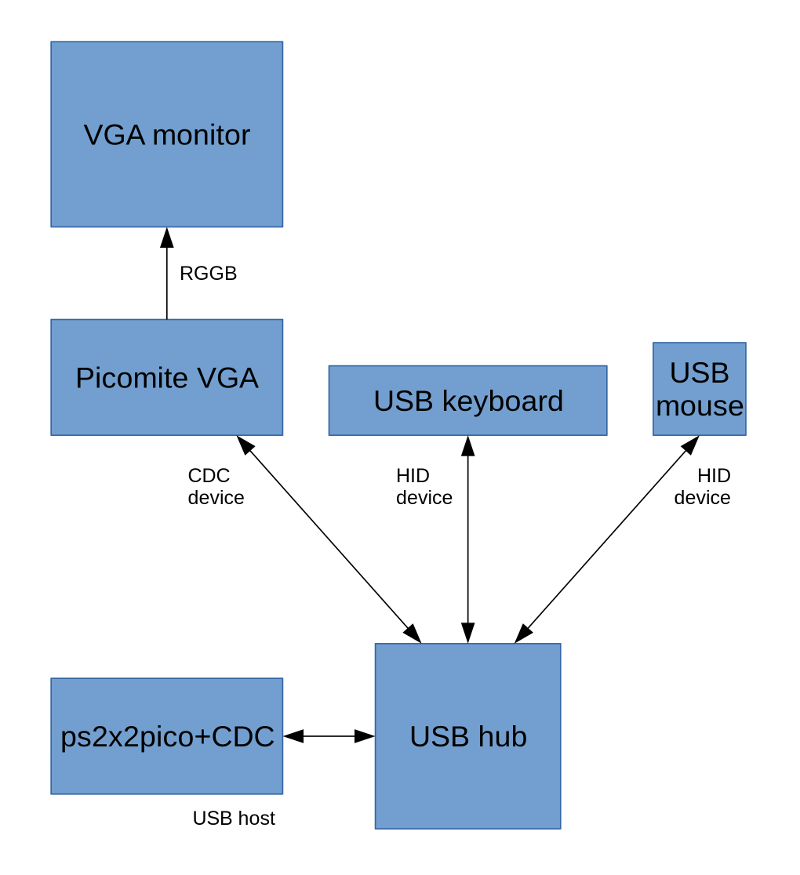

a further idea occurred...
what if the ps2x2pico were extended to ps2x2pico+CDC?
ie, add CDC device support to the ps2x2pico so that it could talk to:
1. a USB keyboard device,
2. a USB mouse device,
3. a USB CDC serial device.
the USB CDC serial device would be a (more-or-less) stock-standard "picomite VGA".
the ps2x2pico would, instead of providing 2x PS/2 output ports, translate keyboard and mouse data into VT escape sequences and send them straight back out to the attached CDC device (aka "picomite VGA").
the "picomite VGA" would then just need to:
A. take input from it's USB port as if a terminal emulator were talking to it,
B. send all output to it's the VGA port.
correct me if i am wrong, but can a picomite VGA not already do this?
rob   :-)

Posted: 02:37pm 23 Dec 2023
issue raised with ps2x2pico author here:
https://github.com/No0ne/ps2x2pico/issues/20
rob   :-)
Posts: 9246
Posted: 03:28pm 23 Dec 2023
Just bear in mind that the PicoMite VGA uses a memory mapped display that is sent out to the video by the second CPU. There is virtually no load on the primary CPU. As such the speed of the display is very fast. Even USB is a serial interface and, as such, has to introduce delays. You won't be able to get the same display speed, just as you wouldn't if it was a serial terminal.
TBH this looks far too complicated. I'd just use a RPi instead - it's far easier and you get so much more for your money.  :)
