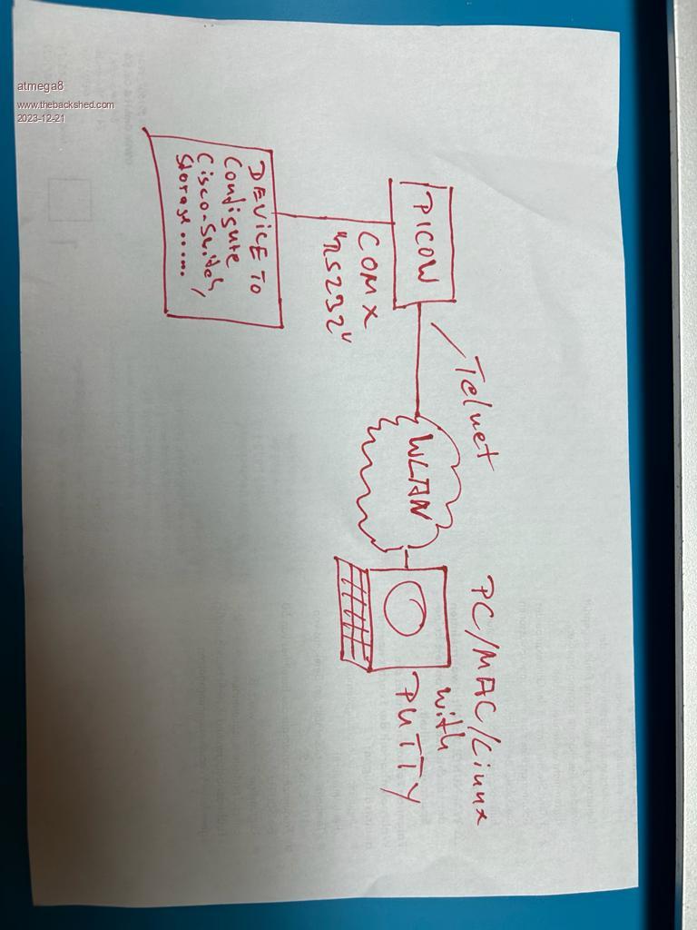

Hello to the world,
I know we live in 2023/4, but in our IT world we deal with high-end systems every day, which are initially still configured via conventional RS232 interfaces.
To avoid sitting in cold data centers and getting sick, it makes a lot of sense to be able to communicate remotely with these systems.
This should be possible with MMBASIC and the PICOW?! Unfortunately, I have a mental block at the moment.
How could this basically be implemented???
Thanks for your intelligent ideas ;-).

Posted: 08:59am 22 Dec 2023
If I understand your drawing, you need an encrypted link across the WLAN.
Looks OK with a Pico W but I haven't studied exactly which kinds of encryption it supports if running MMBasic.
As you'll (presumably) be connecting it to a router, you'll need to make sure it allows traffic through of whatever kind (protocol e.g. https) you choose on whatever port.
You'll also need an IP address & if the router hasn't got a public one then such as dyndns
As it looks like you'd originate a connection from the PC end you likely don't need to mess with the router or dyndns there (I think).
Edited 2023-12-22 19:02 by JohnS
atmega8
Joined: 19/11/2013
Posts: 738
Posted: 09:36am 22 Dec 2023
  JohnS said  If I understand your drawing, you need an encrypted link across the WLAN.
No Encryption needed
Everythinh is internal
Yes.
Posts: 12071
Posted: 10:38am 22 Dec 2023
I don't understand the issue. Set the Pico-W as a telnet server connected to a router that sits on the WLAN. Run a program on the Pico-W that reads console input (telnet) and outputs it on a serial port.
However, this is a catastrophically bad idea as you will need to open the router to pass telnet which is totally insecure and the Pico-W does not support any sort of IP encryption. You could code some primitive encryption in the Pico so that the telnet data is garbled but the protocol itself is open.
I suppose you could create a VPN tunnel from the PC to the router and pass telnet over that which would be more secure but I'm with the consensus above that you should never bring the console connection outside of the data-centre
