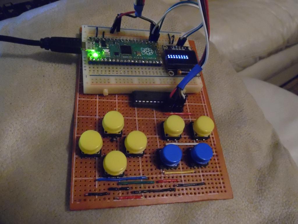

I got mcp23017 port expander and ssd1306 on same i2c to show buttons pressed as binary and works fine...button pad is not as simple to make as seems :)

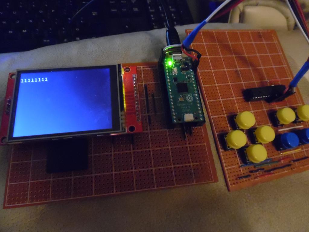

When wired to ili9341 it displays 00000000, so display is working ... but on ssd1306 it's 11111111 for no buttons pressed. works well, pressing 8 buttons gives 00000000.

this is the ili board so 'SETPIN gp20, gp21, I2C not used?? ok for i2c?
> option list
PicoMite MMBasic Version 5.07.08RC18
OPTION AUTORUN  ON
OPTION CPUSPEED  378000 'KHz
OPTION LCDPANEL ILI9341, LANDSCAPE,GP15,GP14,GP13
OPTION TOUCH GP12,GP11
GUI CALIBRATE 0, 3918, 3699, -895, -681
OPTION SDCARD GP22
OPTION SYSTEM I2C GP20,GP21 gives
Error : Pin 26/GP20 is in use
Edited 2023-12-18 09:55 by stanleyella

It works with it wired to same i2c as the ssd1306, it's the i2c and spi ili9341 which is a different board and pico.
I will try another i2c device that works with ssdi306 but use ili9341.
Posted: 05:00pm 18 Dec 2023
I used OPTION SYSTEM I2C gp0,gp1 and it works with ili9341 board ok now??

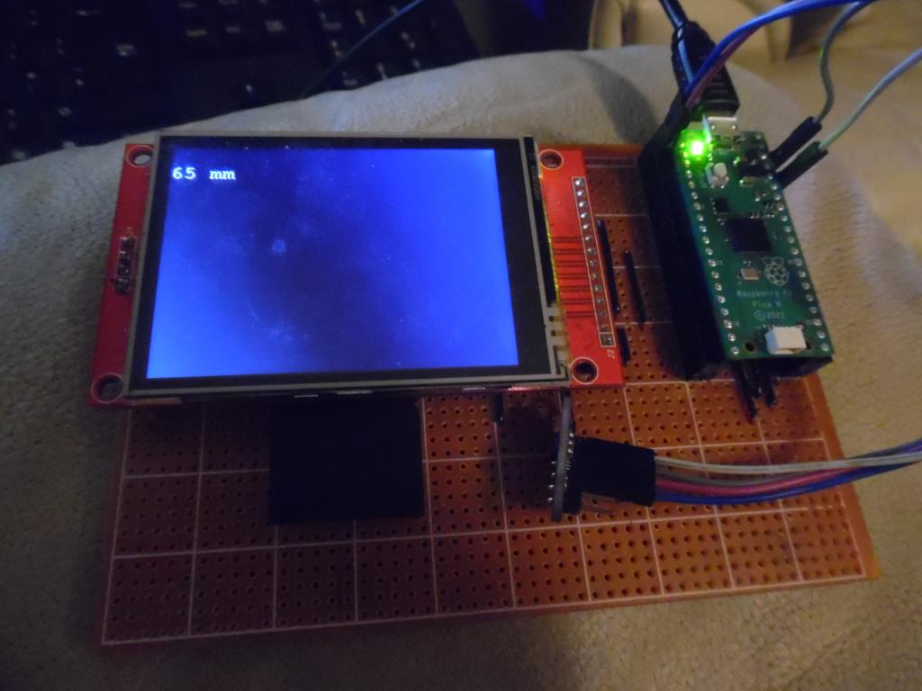

like ssd1306 i2c the i2c range finder works ok with spi. when i2c works it's nice.
