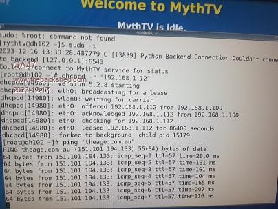

I decided to give my Home Entertainment PC a bit of a birthday as it was still running Windows 7 with Media Player. I looked at an alternative package as Windows does not support Media Player any more. I liked the look of LinHES as it seems to have a similar feel to the Microsoft product and installed V8.6.1 on the hard disk. I have very limited experience with Linux OS configuration and despite hunting through the setup areas I cant get areas of the software to operate. My first major problem I think is that I cant get the unit to connect to the internet via the the cabled ethernet and although it seems to have gained an IP address of 192.168.1.12 and I have set the router address to 192.168.1.100.
Any suggestions before I give up?

Posted: 08:40am 16 Dec 2023
Thanks. I'm using tuners which are DVB-T2, much cheaper & USB (suits me better than PCIe).
You mentioned an odd-looking router address - is it correct?
192.168.1.1 would be more likely, but look at its label / documentation.
If it is correct, maybe look at
ifconfig -a
and
route -n
for clues.
If not root you'll likely need sudo before each of those (e.g. sudo route -n).
Can you ping any sites e.g. aa.com ?

Posted: 08:11pm 16 Dec 2023
Thanks everyone, it seems that I might have inet access as the screen shows but I have configured something wrong.
