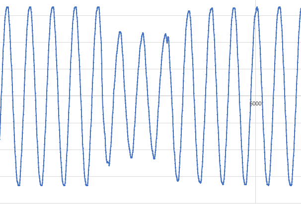

My disturbance recorder has been sitting on the desk in a half finished state for a while now.
Today was it's day to shine.
We are having some severe electrical storms passing by. The closest strike I recorded on the lightning detector system was 0.8kM away in a neighbours spud paddock.
The picomite recorder was ready and this is one of the 'disturbances' recorded.
So far, all the micromites and picomites have survived but there is a few more hours of storms to go.

Nice recording...
But for your equipment not harmfull. Maybe at the neighbours house it is more dramatic...
You can clearly see where equipment switches off.

A textbook recording!
At cycle 5 you can see where the HV surge diverters have blown and are now are now dragging the line volts down about 10%, till the MCB trips or HV fuses blow. Then 2 to 3 cycles of arc quenching.

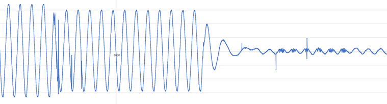

Another disturbance from the same 18 hours of storm cells.

A brief dip like that could be a stick blown across the line.

Neutral gene, 3 phasa unbalance, Someone else tot 300 volt. 60ms. Part of theorie disconnected.
