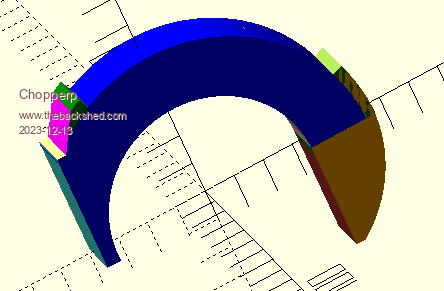

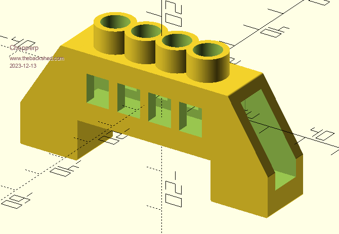

Joined: 03/01/2018
Posts: 1139
Posted: 08:34am 13 Dec 2023
  SimpleSafeName said  "OpenSCAD version 2023.11.24 (git 6ca75dd4e)" at the moment.
Just checked mine....2021.01, better look at updating. Thanks.
  Revlac said   I use it a lot, it will do most things we need, don't expect figurines, animals etc from OpenScad, other programs for that and probably better to use Resin printers for that stuff.
Can do interesting shapes though just using the basic commands. This one was a bit of a challenge working from a 2D drawing.
