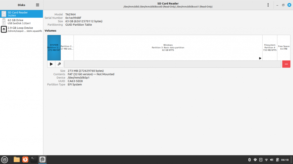

Posted: 06:29am 22 Dec 2023
I've got my hands on this machine again now, cos it has basically crashed on W11 to the point that a literal snail is faster then it is - literally.
I used Mint to see what was going on inside, and even Mint thinks that the Windoze volume, is actually an SD card, probably embedded into the mainboard.
Wow.
Windoze itself ID'd the system drive as SD, and now Mint backs that up, which suggests that HP have used an embedded SD card as the SSD, which is one of the most horrible ideas I have ever heard of - for Windoze.

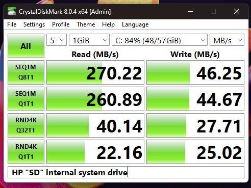

Posted: 07:36am 22 Dec 2023
Speed test on the "SD" system volume on that laptop:
For W11, this is not really very good at all.....
Check out the write-speeds.
Crikey.

  Grogster said  Oh, and BTW - model number is: 14s-fq0553AU
The web / HP say it has 64GB eMMC.
4GB RAM is a bit small for W11 (?)
If using Linux don't go for a big-RAM highly-featured GUI variant on that HP thing.
Posts: 9246
Posted: 10:12am 22 Dec 2023
Mine's using eMMC too. It's not fast stuff at all but it's very cheap and you can't have everything. The much newer eMMC isn't bad at all, but it's more expensive, of course.

@ John - Yes, 4GB is way to small for W11 IMHO.  I would normally build a W10 or W11 machine with a minimum of 8GB, preferably 16GB of RAM.  A slow CPU with small amount of RAM and slow eMMC system drive, is pretty much a classic recipe for a snail.
