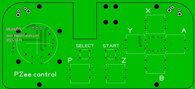

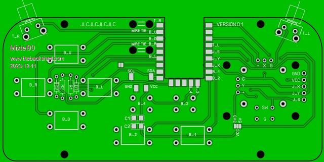

At the risk of boring you all to tears this my latest idea.
First the failures:
No case. The idea is to put another (full size, not notched) board or plastic underneath it. It looks a bit gross!
No standard connector. There isn't one for I2C.
This isn't really what would like (because there's no case).
It's not directly supported in MMBasic, but it doesn't need to be as I2C is easy enough.
Probably limited to two controllers at 400kHz. Probably more at 100kHz, with a maximum of 8 on one I2C port.
Then what I see as advantages:
I2C - will work on anything.
The I2C address cam be easily changed so you can have up to four controllers on two pins.
Easily re-programmable in MMBasic, C, Python etc.
Can be used in both analogue and digital modes
There are effectively 15 digital controls or 11 digital + 2 analogue directions,
Not tied to any particular connector
Reasonably cheap to build.
The slot in the top accepts a RP2040-Zero fitted from the bottom of the board. The two shoulder buttons are fitted underneath the board, the gap between the board and the back
The yoystick can be either the module often seen as part of the sensor kits or the bare joystick module itself, easily found on ebay and AW.
Overall size is approx. 120x55mm.
The intention is to use 1/2 of a 2m RJ14 modem lead for each controller. However, the important thig is to have I2C, 3V3 (or 5V) and GND. This works out on the PicoGAME D9M connectors as well. It's just a case of fitting a D9F plug and running the right software.
Despite the odd shape, the pcbs are only about £5.50 + postage etc. for five from JLCPCB.
EDIT:
Incidentally, the pins used for the I2C interface (GP8 - SDA and GP9 - SCL) are also COM2 TX and RX so there's a little flexibility included there.)
Edited 2023-12-12 00:51 by Mixtel90

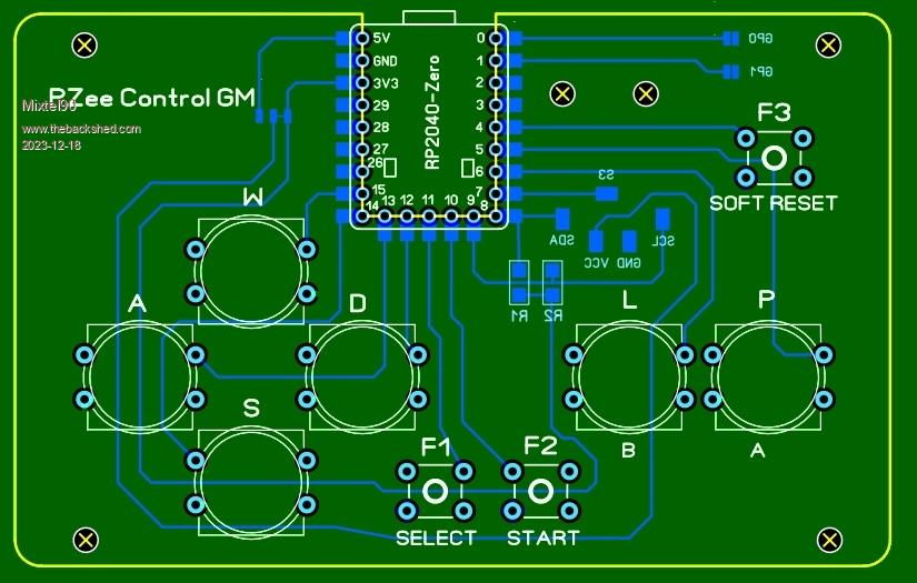

Here's a reduced version for those who prefer the Game*Mite controls. I think all the buttons are in the same places. Soft Reset simply sends the code for F3 and the game can treat it in any way.
It is envisaged that this would be I2C by default (again). Other options are possible:
I2C with interrupt on S3 wire.
TTL serial - gp8 is com2 tx, gp9 is com2 rx
emulated NES - S3 wire is Latch (this would be much slower to read than a real one)
HID connection over USB
R1 & R2 are optional and need only be fitted if the host hasn't got I2C pullups. Could be handy for a Micromite backpack. :)
I'd probably do this single sided again, just because it looks a bit neater. The RP2040-Zero is surface mounted from the rear again, although it's not obvious in the pic.
GP0 and GP1 are there just in case there's a use for them at some stage. :)
