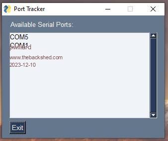

A simple python script can keep track of active ports...
# Name:
# Purpose:     Simple tracker for active serial ports attached to windows PC
# Author:      Pete Willard
# Created:     15/08/2023
# Copyright:   (c) willard 2023
# Licence:     CC BY-NC-SA
import serial.tools.list_ports
import time
import PySimpleGUI as sg
def main():
   layout = [
       [sg.Text("Available Serial Ports:")],
       [sg.Listbox(values=[], size=(40, 10), key="-PORTS-")],
       [sg.Button("Exit")]
   window = sg.Window("Port Tracker", layout)
   while True:
       event, values = window.read(timeout=1000)  # Auto-update every 1000 milliseconds
       if event == sg.WINDOW_CLOSED or event == "Exit":
           break
       refresh_ports(window)
   window.close()
def refresh_ports(window):
   ports = [port.device for port in serial.tools.list_ports.comports()]
   window["-PORTS-"].update(values=ports)
if __name__ == "__main__":
   main()
Could be modified to show Device ID, if you really wanted it I suppose.

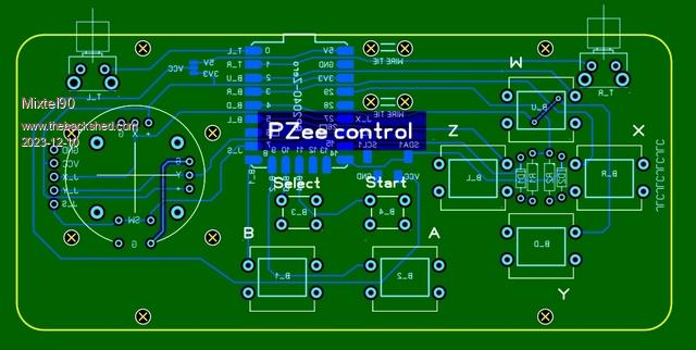

My I2C controller (PZee Control) has the USB-C port in a good position to use it with a USB-C lead to a PC. Sending hex to the console should be fine. As I said though, it is just a PCB without a case.

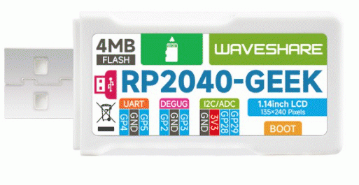

Perhaps that Waveshare RP2040-GEEK usb module pointed out by Bernie3D, with I2C and serial, would be just the ticket for attaching a controller to MMB4W.

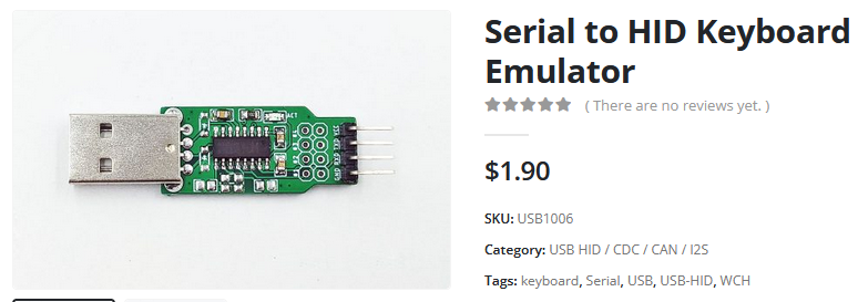

I have some of these but haven't had time to play yet.
This module is a serial port to HID device, which is recognized as a standard USB HID keyboard device on the computer. It is suitable for one-way data transmission. It can receive the data (such as ASCII code) sent by the serial port, and according to the HID keyboard device specification, package the data into a standard keyboard code value and upload it to the computer through the USB port.
Through the provided host computer software, users can also configure the chip’s VID, PID, and various character string descriptors by themselves. No need to drive, plug and play.
Features:
   Support 12Mbps full-speed USB transmission, compatible with USB V2.0.
   The default serial port communication baud rate is 9600bps, which supports multiple serial communication formats and various common baud rate settings.
   Support 5V power supply voltage and 3.3V power supply voltage.
   You can configure the chip’s VID, PID, and various string descriptors of the chip by yourself.  (upper machine software)
   You can configure the default baud rate of the chip by yourself. (upper machine software)
   Comply with USB related specifications and HID device related specifications.
   A variety of working modes, application of different needs, can simulate the full keyboard function.
   The operation of the setting mode is simple and clear, it is easy to use, convenient and fast, and the information is complete.
https://www.electrodragon.com/product/serial-to-hid-keyboard-emulator/
