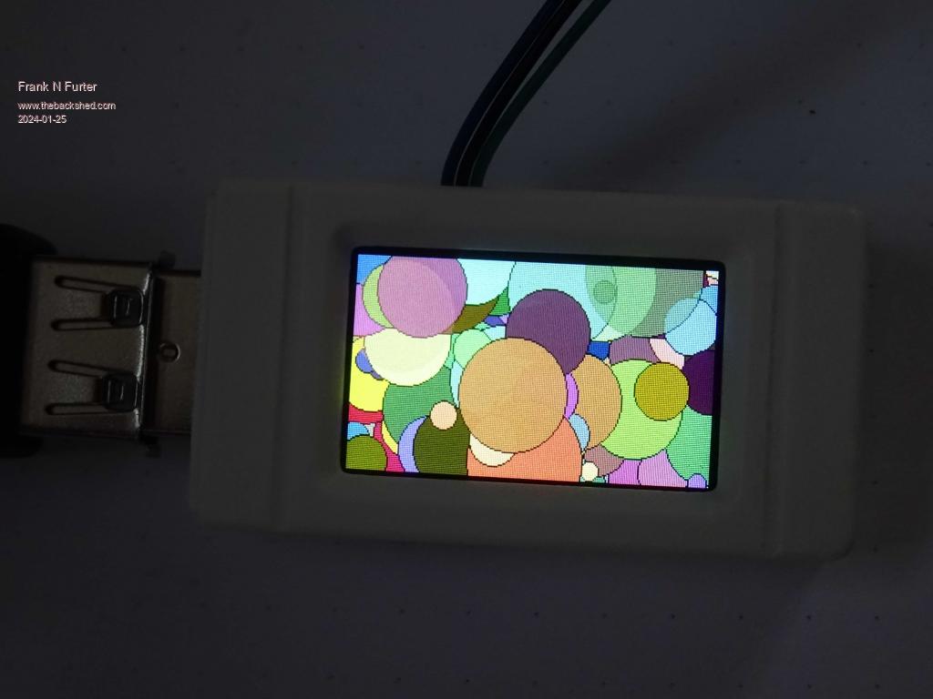

Thank you for pointing out this beautiful board! It really works fantastically!
These are my settings:
OPTION HEARTBEAT OFF
OPTION PICO OFF
OPTION SYSTEM SPI GP10,GP11,GP28
OPTION LCDPANEL ST7789_135, LANDSCAPE,GP8,GP12,GP9,GP25
OPTION SDCARD GP23, GP18, GP19, GP20
OPTION AUDIO GP2,GP3', ON PWM CHANNEL 1
It is possible to connect COM2, PWM2 or I2C1 to the UART socket.
I2C2 or PWM1 can be connected to the DEBUG socket.
With the I2C/ADC socket, GP29 should be able to be used as ADC3 (not tried) - GP28 is already used for SPI MISO and therefore probably cannot be used...

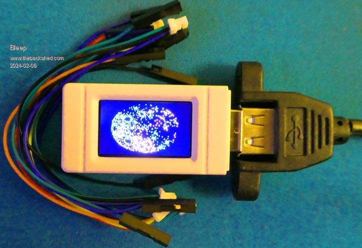

I got mine on Ebay, quick delivery and not overpriced at £12.30. I installed the latest MMBasic and tested at 378MHz with the above options, all looking great. The display looks much better than the photo would have you beleive. :-)
Regards Kevin.
