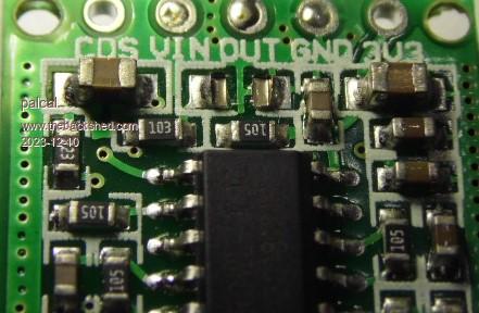

Thanks Jim I've been using au.pool.ntp.org. Everything seems to be working OK as far as the PicoWeb is concerned. Now having a bit of trouble with the RCWL-0516 Radar Sensor, it was working OK, just ordered some more.

Found out why the Radar Module did not work.There is a cap missing top of photo. I have 5 one is OK one had the cap floating around in the wrapper and 3 had no cap at all.

I used the one with cap still attached but still had trouble, I found that whilst the cap was stuck in place it was not connected. I removed it, cleaned and resoldered.
Now working OK. These boards are not very good quality but what can you expect for cheap boards from China.
