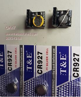

I have a handful of these DS3231 RTC modules in the shed and have found that the 3V battery does not last long when the devices are not powered. I have searched for replacement leaded batteries but unfortunately the cost of the replacement battery is higher than the purchase price of the module including the battery. As I don't like the thought of the wastage I have been able to replace the leaded battery with a standard button battery that cost around 50 cents. With the help of a slither of heat shrink and some tinned wire I was able to connect the new battery and restrain it at the same time. Maybe this hack may help other shedders with these modules.

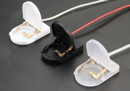

I use CR2032 battery holders on flying leads. Cost $1 plus battery and lasts a long time
Those soldered on batteries are a nuisance.

Those tiny modules are ok, I think. All they have on them is the DS3231, two 4k3 pullup resistors on SDA & SCL and a decoupling cap. I can't find any other components apart from the battery. Supply negative and battery negative are common, the battery + terminal is the closest to the connector. If there's PCB space and a GND connection you only need to run one wire to power it from an external battery (take the old one off first!). The DS3231 won't charge the battery.

It is true that the module as shown in the first image has two 4K7 resistors and a small decoupling capacitor.
The resistors are for the SDA and SCL as a pullup resistor and for the charging section with the 4K7 SCL resistor and a coupling plus button cell and battery pin DS3231.
So a current can flow to the battery, but also back via the same resistor if the module is included in a circuit because there is no diode on this module.
A cold cap can also be used as a backup battery.
If you want to use a normal 3V button cell battery, disconnect the battery pin of DS3231 from the PCB and connect it with a loose wire to the plus 3V button cell battery.
There are also DS3231 modules with RTC and an eeprom with I2C where a resistor and diode are present in series as a charging circuit. These must be interrupted if you want to use a normal 3V button cell.
