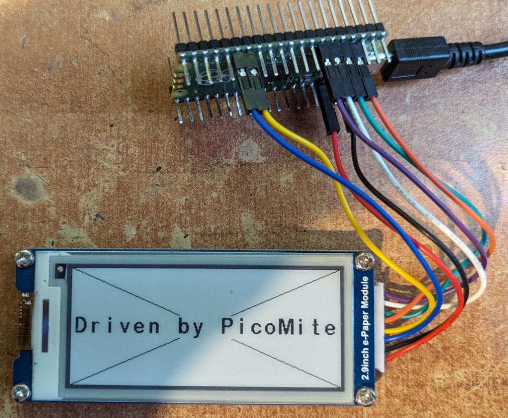

Try this
PicoMite.zip
' PicoMite driver for 2.9" e-INK display
' The MMBasic graphics commands update a memory image of the display and the user should call paperREFRESH
' to update the physical display
' Updates take just less than 3 seconds
' EPD2IN9 commands
Const DRIVER_OUTPUT_CONTROL =&H01
Const BOOSTER_SOFT_START_CONTROL =&H0C
Const GATE_SCAN_START_POSITION =&H0F
Const DEEP_SLEEP_MODE =&H10
Const DATA_ENTRY_MODE_SETTING =&H11
Const SW_RESET =&H12
Const TEMPERATURE_SENSOR_CONTROL =&H1A
Const MASTER_ACTIVATION =&H20
Const DISPLAY_UPDATE_CONTROL_1 =&H21
Const DISPLAY_UPDATE_CONTROL_2 =&H22
Const WRITE_RAM =&H24
Const WRITE_VCOM_REGISTER =&H2C
Const WRITE_LUT_REGISTER =&H32
Const SET_DUMMY_LINE_PERIOD =&H3A
Const SET_GATE_TIME =&H3B
Const BORDER_WAVEFORM_CONTROL =&H3C
Const SET_RAM_X_ADD_START_END_POS =&H44
Const SET_RAM_Y_ADD_START_END_POS =&H45
Const SET_RAM_X_ADDRESS_COUNTER =&H4E
Const SET_RAM_Y_ADDRESS_COUNTER =&H4F
Const TERMINATE_FRAME_READ_WRITE =&HFF
Const CE0 = 4
Const DC = 5
Const RST =6
Const BUSY = 7
Dim integer lut_full_update(29)=(2,2,1,&H11,&H12,&H12,&H22,&H22,&H66,&H69,&H69,&H59,&H58,&H99,&H99,&H88,0,0,0,0,&HF8,&HB4,&H13,&H51
, &H35,&H51,&H51,&H19,1,0)
SetPin gp10,gp11,gp12,spi2
userdisplayinit(0)
Line 0,0,MM.HRes-1,MM.VRes-1
Line MM.HRes-1,0,0,MM.VRes-1
Box 0,0,MM.HRes,MM.VRes
Text MM.HRes/2,MM.VRes/2,"Driven by PicoMite",CMU,3
paperRefresh
End

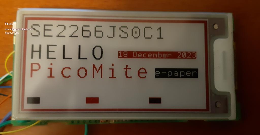

Meanwhile I have made my own investigations about the display and concluded that my display does not have the same driver chip as yours. In fact I found a datasheet that I started to work on: 2.66" datasheet PervasiveDisplays
'Testing of e-paper display marked SE2266JS0C1.
'The display is connected to a board with powersupply control and other
'supporting components.

I have now managed to fill areas of the display with Black, White and Red. Not very useful, but at least some kind of starting point.
Thanks!

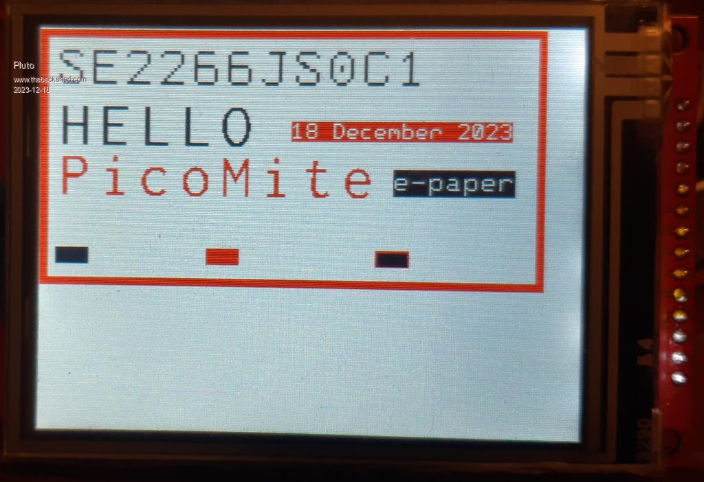

Maybe not the most elegant way to use the e-paper...
Step 1: Display the text/graphics on ILI9341 LCD in Black, White and Red
Step 2: Extract the black pixels from LCD into an array
Step 3: Extract the red pixels from LCD into an other array
Step 4: Send the arrays to the e-paper.

Black/Red/White graphics can also easily be displayed, once you get it displayed on the LCD.

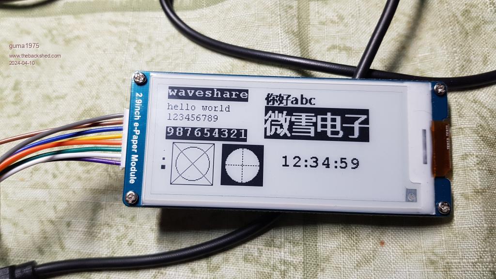

Posted: 05:57pm 09 Apr 2024
Hello and welcome.

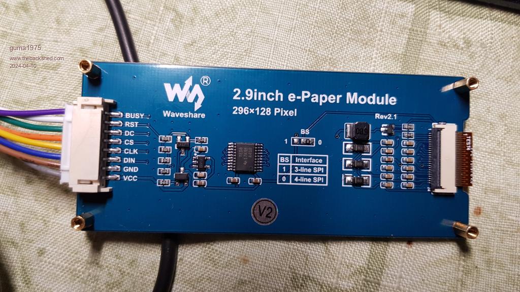

I tried to connect a 2.9-inch waveshare and try the driver as in the first post... But it turned out that I had version v2 296x128 or 128x296. Is there any possibility for v2 to work? When I looked at v2, there are a lot of differences, but since I'm new to this wonderful Picomite software, I'm slowly giving up... Can you tell me where and what to change? From what I've gathered, the initialization is probably different and due to the handling of gray levels, it's very complicated for me... I'm trying to understand what this lut_full is, but I'm probably rusty because I'm from 1975... hihi... Regards and warmest regards thank you in advance for any help... PS... Sorry for my English, but it's because of the translator....
From what I saw on the 1054z oscilloscope, the pins work correctly....
Here is a photo of this display from the back.
From the front it looks the same as in the first post.

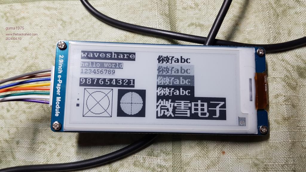

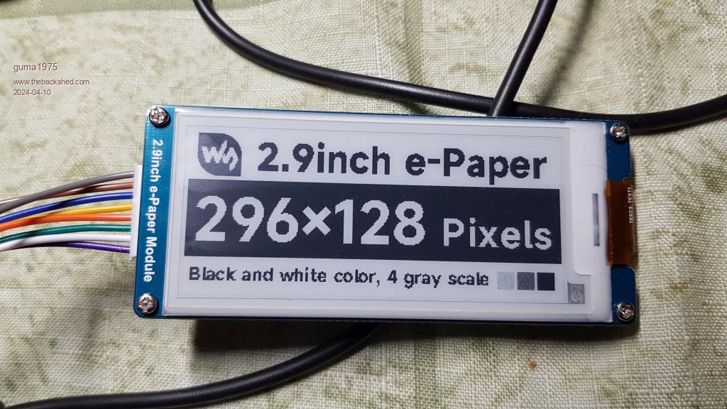

I thought it was damaged but I managed to find a ready-made uf2 demo for pico and upload it from github and it works...
But luckily, I don't know C, and for me, basic is still manageable in play at this age...
I am attaching photos of the finished uf2 from github...
Thank you all for such a beautiful gift in the form of picomite and for your contribution to this project. For me it's something beautiful - you can touch BASIC with such powerful functions. Best regards again. rubber1975.
