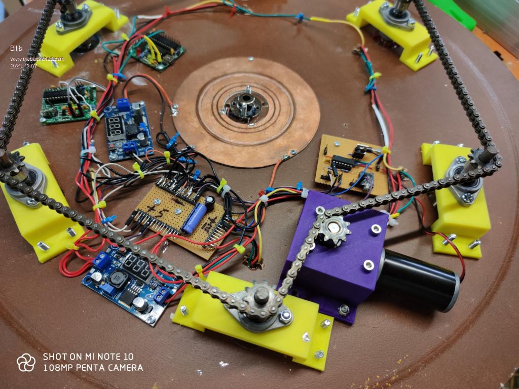

How do you get power (and data?) through the various rotating axes?
Hi vegipete,
I use a simple slipring and carbon brushes.  Generally I use a piece of blank printed circuit board  on the rotation section.  On some unites where data is transferred I scribe several sections on the disc and use serval brushes. The data is generally ON/OFF Bits.
This is the underside of the cup rides rotor. The outer side if the disk is +12V the shaft is the negative and the inner disk is the control bit to start and stop the motor.
the two pic32mx 170 boards have been replaced with picomites to drive the LEDs.
Edited 2023-12-07 11:16 by Bill.b
Posted: 03:03pm 07 Dec 2023
Thanks for showing us the underside of your brilliant handiwork. Outstanding.

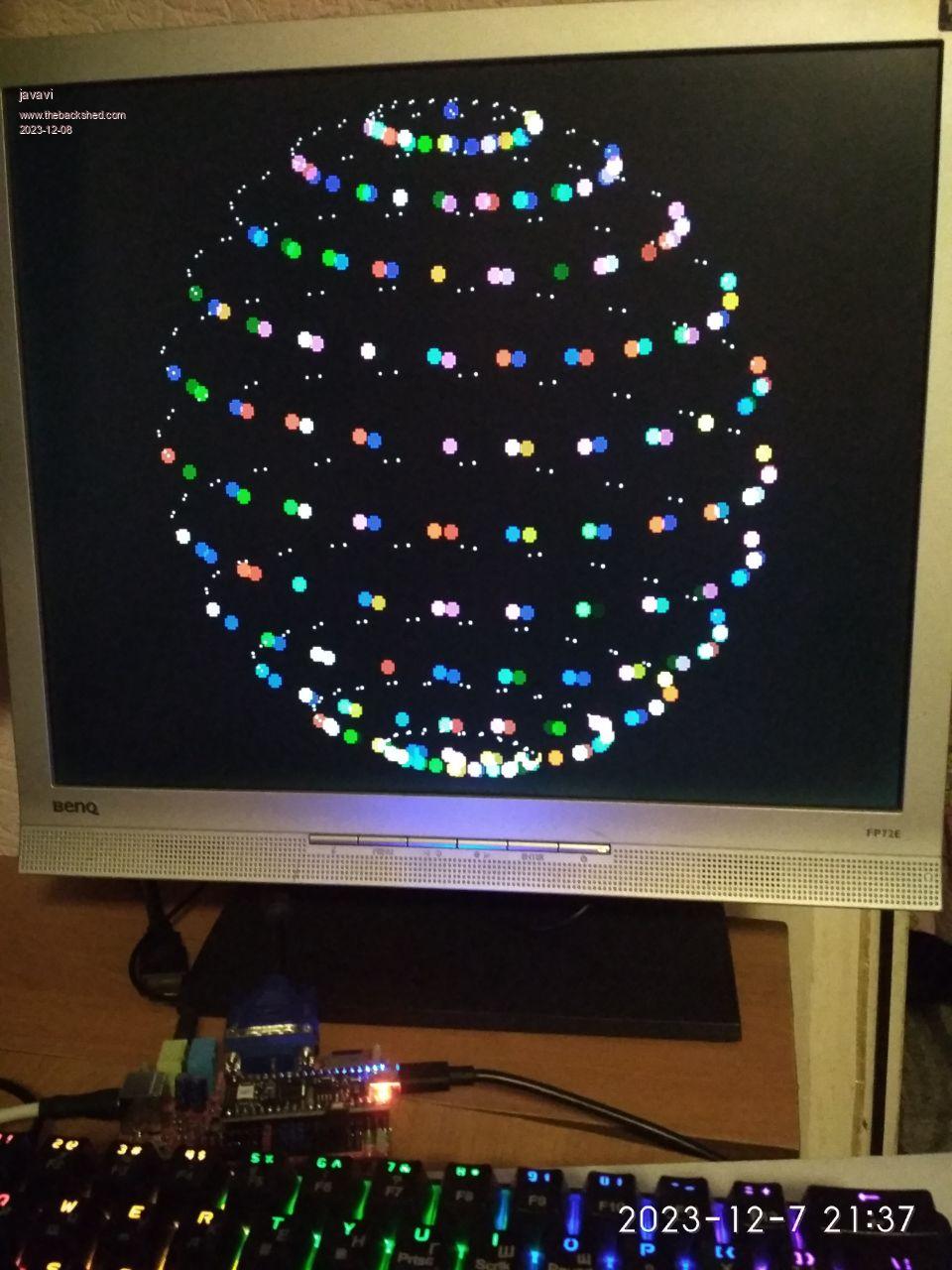

Option ANGLE DEGREES
FRAMEBUFFER CREATE
FRAMEBUFFER WRITE F
RX=MM.HRes: RY=MM.VRes: CX=RX/2: CY=RY/2
Umin=-180: Umax=180: Ustep=15
Vmin= -90: Vmax= 90: Vstep=15
SCALE=CY-CY/10
 For S=0 To 12 Step 3
 CLS
   For V= Vmin To Vmax Step Vstep
   For U= Umin To Umax Step Ustep
     U=U+S
       X=Cos(U)*Cos(V)
       Y=Sin(U)*Cos(V)
       Z=Sin(V)
     U=U-S
     C=Rnd*&hFFFFFF
     Plot_XY
     If Inkey$ <> "" Then End
   Next U: Next V
   FRAMEBUFFER COPY F,N,B
 Next S
Sub Plot_XY
 X=SCALE*X: Y=SCALE*Y: Z=SCALE*Z
 Y=Y/4
 X1=X-Y+CX: Y1=Z-Y+CY
 If y<0 Then
   Circle X1,Y1,2,,,C,C
 Else
   Pixel X1,Y1

Hi Bill,
I see you are using a few of my MuPs PCBs there!
I am flattered.
Bill.b
Joined: 25/06/2011
Posts: 249
Posted: 02:20am 08 Dec 2023
Hi Mick
That photo is approx 2 years old. The Mups have been replaced with picomites in the current version of the cup ride.
