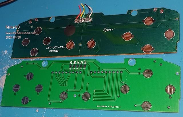

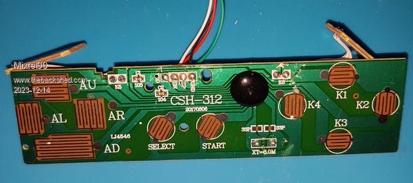

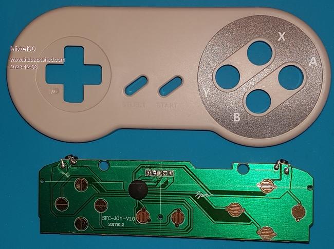

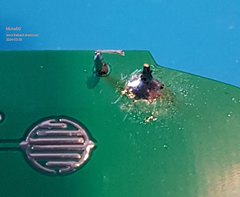

The cheap "SNES" controllers available from China aren't always what you expect inside. The cases seem to be reasonable, but the guts can actually be NES!
Tom asked if it might be possible to convert them into "proper" SNES controllers by swapping the PCB. I couldn't resist a challenge like that, so here's a naked SNES controller in all its glory.
A bit of examination reveals that the left trigger button is in parallel with Y and the right trigger is in parallel with X. These pairs share a common from the chip, the other sides coming from A and B, with more chip connections. One side of all other buttons (including A and B) are grounded. Some sort of multiplexing seems to be going on.

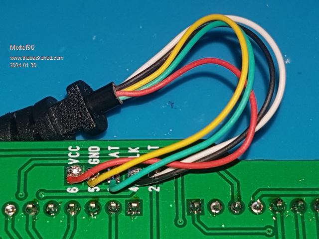

Connections from left to right are: VCC, GND, Latch, Clock, Data. In this case the wire colours are Red, Yellow, Green, Black, White respectively.
The PCB is single-sided and just over 1mm thick. The trigger switches are standard 6mm tactile switches with the connections trimmed off one side. The remaining connections pass through holes in the PCB and are soldered. Mouldings in the case behind the switches prevent pressure damage.
You may have noticed that I've scribed lines in the solder resist. I need reference                    points to get the hole positions right. I've spent quite some time on this today sorting the outline and some preliminary component positions out.

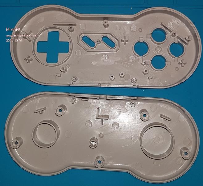

The case has plenty of mouldings in it to give support to the thin PCB under the action of high pressure fingers! There are no-go areas on both the bottom of the board, where you'd expect them, but also round every set of switch contacts.
It looks like it might just be possible to do a through-hole design if components are mounted on the bottom side of the board. There is more height there (between the two big tubes in the bottom moulding). SMD on the other side might be more of a challenge.

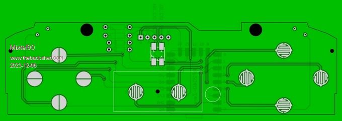

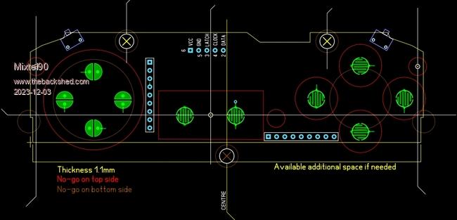

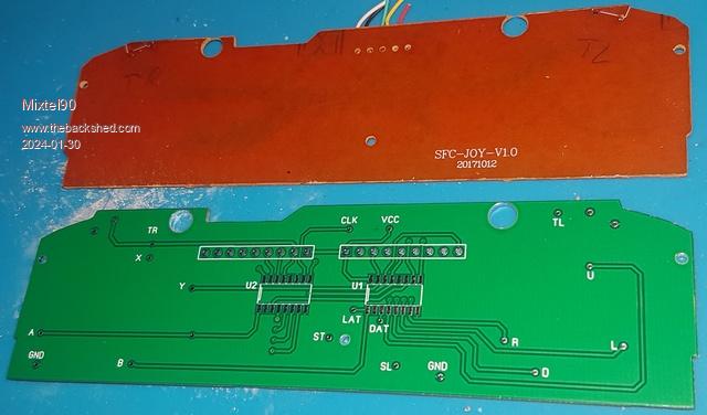

This is the basic PCB that we can work from:
I've put the trigger switches on and tentative positions for two 8-way commoned resistor packs. I've done the drawing SL6 rather than CAD as that's where I'm going to need it and I can't directly convert between them. It's a pity because using CAD for this would have been easier.

I have one of these open on my desk and the internals are slightly different. The two large circles in the bottom shell are the same size (the smaller of your two, I think,) bosses are a bit different and the pcb (with white drop chip) is a simple rectangle, 109mm x 37mm. I'll post some photos later.
Posts: 9246
Posted: 06:48pm 03 Dec 2023
I can't see this being a generic board swap, unfortunately. as I suspect there are many variations in the mouldings. Especially in the positioning of fixing and switch pad locating holes.

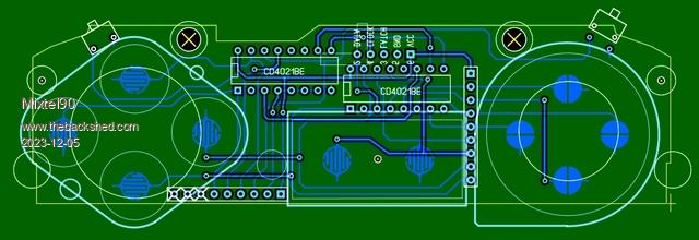

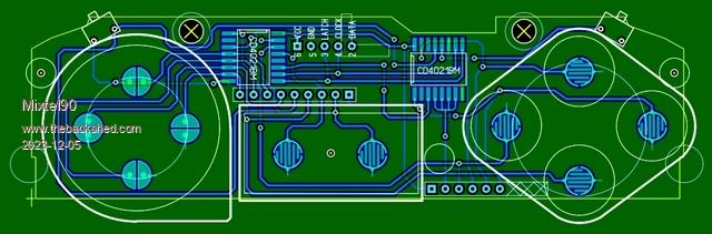

I now have two different approaches to the problem. The copper side of the PCB has far less height available than the bottom, but is OK for SMD. Both sides have the problems of obstructions either abo or below the board - or both!.
I don't mind this through-hole approach, but the space available for the resistor pack pins is tight.
I've cheated on both versions. The official(?) circuit uses separate pullups for each of the four unused inputs. This is pointless for CMOS inputs so I've used a single resistor. The three unused ones can be simply ignored after cutting their pins off. This saves on length. Alternatively five single resistors could be commoned up.

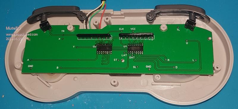

This is my preferred design, I think. I put the resistor packs on the bottom of the board again to avoid clashes with the flexible button pads. I think the SMD parts are also easier to get.

After reassembly I've just tested this particular Chinese controller on a PicoGAME V2. It is mapped as follows:
red = bit 0
blue and right trigger = bit 0 rapid fire
yellow = bit 1
green and left trigger = bit 1 rapid fire
select = bit 2
start = bit 3
up = bit 4
down = bit 5
left = bit 6
right = bit 7
As you can see, despite it's appearance it is a NES controller.
I gave it the full 16 clocks to make sure.

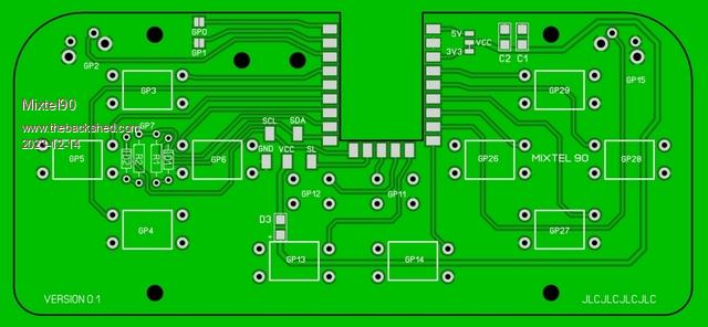

I think I can fit a RP2040-Zero into the SNES case. That would be interesting because I wouldn't need any pullup resistors or DIP switches to change the address etc.
Posts: 9246
Posted: 11:56am 06 Dec 2023
I couldn't resist this. I2C version for I2C2 only because those are the pins that would be the wires available on the NES D9 plug. Embedded computing courtesy of a Waveshare RP2040-Zero. There is a WS2812B on the front controlled by GP10. This will normally be lit in one of the four button colours to indicate the I2C address. Hold down Select during power up and the LED lights up magenta. Press a colour button to select that channel. Hold down Start during power up and the LED lights white or green to indicate whether pullups are disabled or enabled. Press Select to cancel or Start to toggle. After any config it enters normal mode. It only returns two bytes: the first is all the bits on the direction d and colour buttons. The other has the two triggers, Start & Select. That's the general idea anyway. I couldn't use Reset rather than power up as Reset isn't out to a pin on the RP2040-Zero.

I've ordered a pair of the very cheap SNES USB controllers from ebay. I want to see if the same PCB can be used with those. If it can I intend to provide  the gerbers for the above through-hole version and the I2C version. I don't think many people will will want to solder the SMD one.
I've added a switch to the I2C version to initialise the config system rather than using power-up. Just a tac switch that needs a pointy thing to operate it. I prefer that idea to having to run a config program as it means the controller can be used with any I2C host.
Further plans are to allow re-mapping of everything. This would be very useful for those who are left-handed or who have disabilities. That would have to use a config program though, I think.
I'm intending to simply remove the USB board and its cable and replace it with the new board and 1/2 of a 2m RJ14 4-core modem lead. That gives a flexible lead & a plug. The PicoGAME 4 will be able to accept two RJ14 sockets instead of the D9M as an option. These will be on the second I2C port (GP0 & GP1) so the WII controller will be able to be used at the same time!
