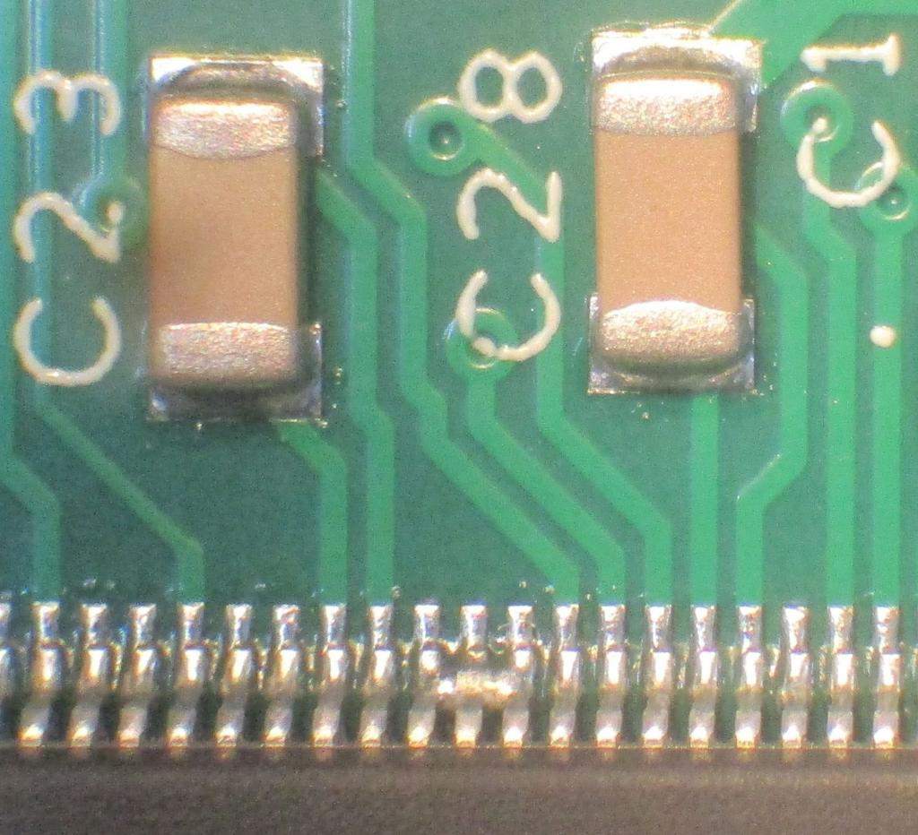

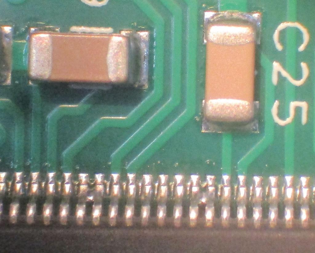

One of the CMM2_G2 boards I got back from them.
All the other boards are fine - I checked.
Look carefully at the photos.
No, those pins are NOT supposed to be bridged.
I could not work out initially, why this board flatly refused to talk to the cube programmer, no matter what I did.  When I put it under the microscope, all was revealed, and it was the "A-ha!" moment.
I COULD moan to JLC about this, but it is the first board with any pin bridging I have EVER got from them out of close to 100 CMM2 boards I have had them make since the CMM2 design was released, so it would be a little petty of me, when a dab of flux and a quick drag-solder movement, completely cured the issue, and then the board programmed just fine.
I am surprised though, that the AOI(automatic optical inspection) process as part of the factory QC, did not detect this and reject the board.
Ah well.  It's not a problem in any event.

@ Mick - I wouldn't worry.  JLC have been VERY consistent and reliable with both their plain PCB's, and also their SMD assembly process.  I'm sure your boards will be fine.
I just posted the thread to illustrate that even factory production can get it wrong from time to time.
As I said, I COULD moan about it to JLC and send them the photos, but it was mere seconds to fix the bridging myself, so I am not worried about it or ordering SMD assembly from them again.
What actually raised my eyebrows more then anything, was that the AOI did not detect it - AOI is usually pretty good at picking up on those sorts of faults.
