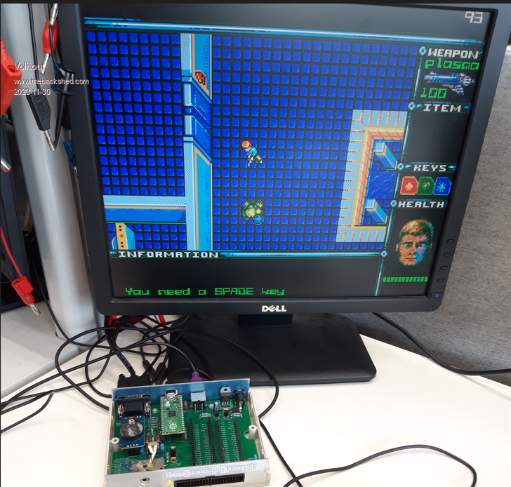

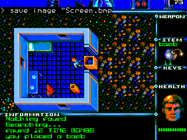

The development of the PETSCII ROBOTS game (original designer David Murray aka The 8-bit guy) for MMBasic for the PicoMite is in beta phase.
The game should have all game elements implemented. In this phase we are looking for testers. People who want to play the game, and report problems with functionality of compatibility.
Attached in this post are
- the original game manual
- the game itself
- picomite firmware versions for picomite and picomiteVGA (V050708RC21)
The game will run on:
- Picomite VGA platforms, using keyboard control
- Game*Mite platform (LCD), using the 8 buttons for playing. You must start the game using the keyboard though, since it is not autorun becuase you replaced the GameMite firmware.
- PicoGameVGA platform, using either keyboard or NES controller.

This game is partly a shooter, and partly a puzzle game (you can never win if you just shoot every robot you encounter).
Read the manual before playing the game, it enlightens, and explains the keyboard controls.

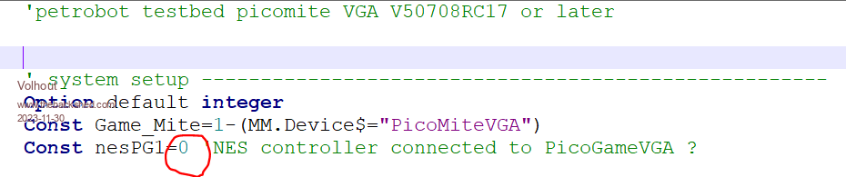

There is a bug in the code
  Quote    Option default integer
 Const Game_Mite=1-(MM.Device$="PicoMiteVGA")
 Const nesPG1=0 'NES controller connected to PicoGameVGA ?
 If Game_Mite Then
   nesPG1=0:sc$="f":init_game_ctrl ' Init Controller on Game*Mite '************
 Else
   sc$="n":MODE 2
 If nesPG1 Then config_nes
Starred line fails as cannot change a constant

Thanks Peter,
We hate these last minute changes. The change was not tested on a Game*Mite. Good thing you did.
pet25e.zip
bugs fixed:
- Peters find: nesPG1 constant definition fault

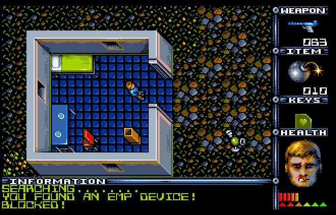

  Quote   when moving a closed box with hidden item, the item moves with it
Yes, tried, works.
In the video I had the problem to have moved away the box and the item was no longer in it.

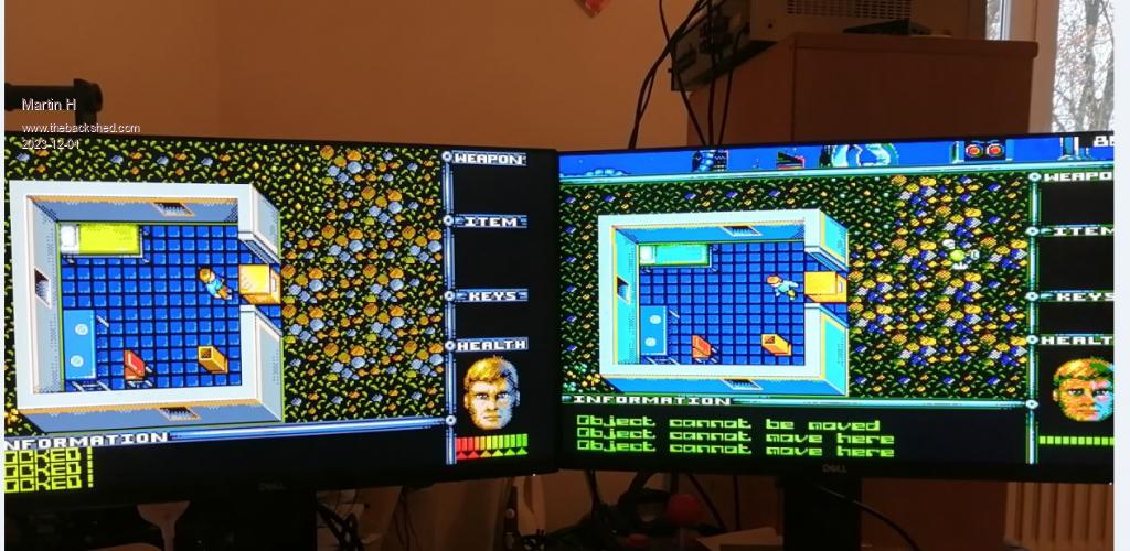

I thought I had found another bug.
You can block your own path by placing boxes in external doors but the same thing happens in the Dos version.
so its not a bug
but There's a slight difference:
In the Dos version, objects in the direct area of the bomb can be destroyed. and you can move on
on Pico they just open and you are stuck .. esc to end the Game
Edited 2023-12-01 19:14 by Martin H.

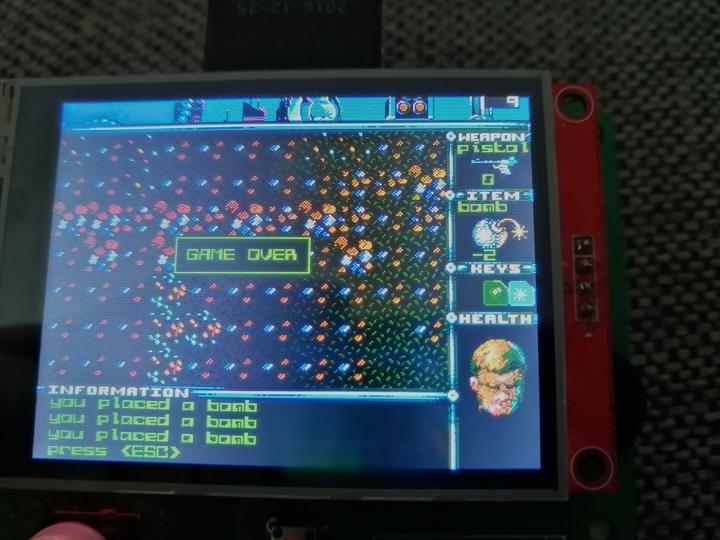

another special feature in the gameplay...
somehow you can have a negative number of Timebombs (and use them)..
Edited 2023-12-02 18:51 by Martin H.

Posts: 6199
Posted: 09:56am 02 Dec 2023
Thans Martin,
I will look at these. Both should be easy to fix. I assume the plasma gun would also destroy boxes.
