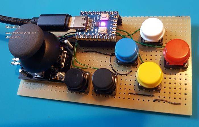

I've been using a RP2040-Zero as an I2C expander for a controller (I'm just doing a hardware prototype at the moment). It has a lot of advantages. I can program a cheap analogue joystick module as either analogue X-Y or as digital by using the PicoMite as comparators. I can also change the I2C address under software control! :) Pretty cheap from AE too.

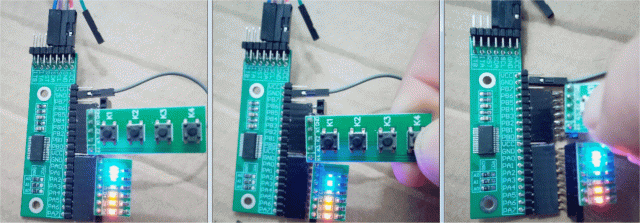

The 8 button pad was inspired by others pcb but I could get by without it. The challenge until my attention span wains is sorting this expander.

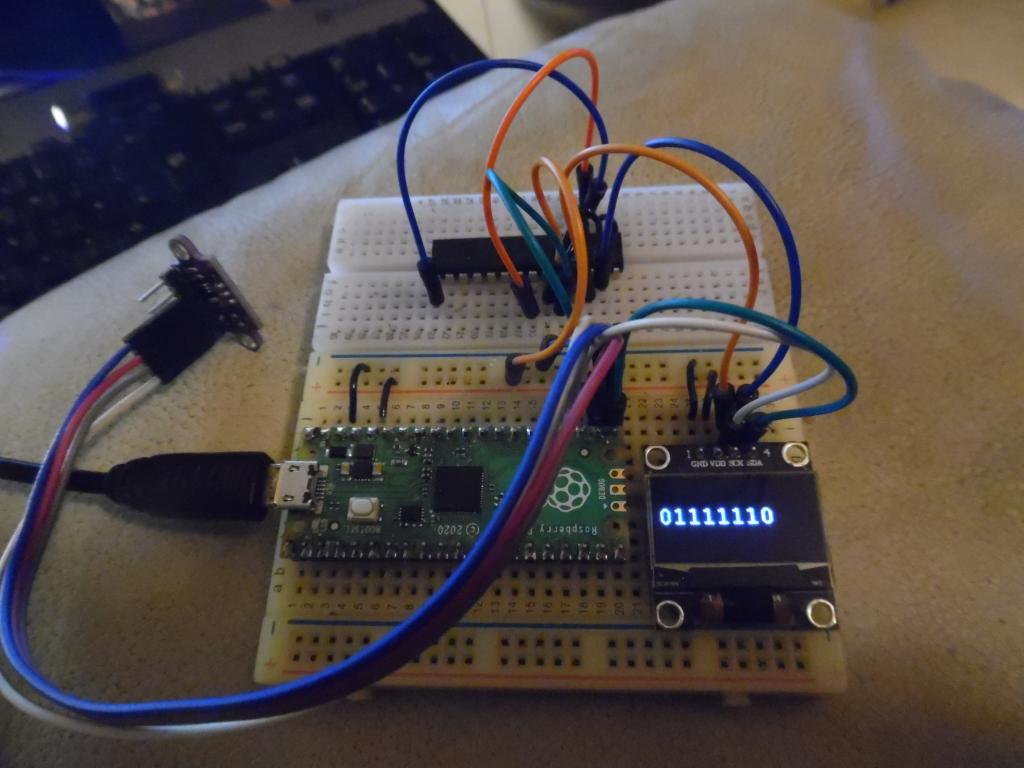

I'm using the mcp23017 and v53lox laser range finder and ssd1306 on same i2c pins same time no prob and it's tidy wiring.

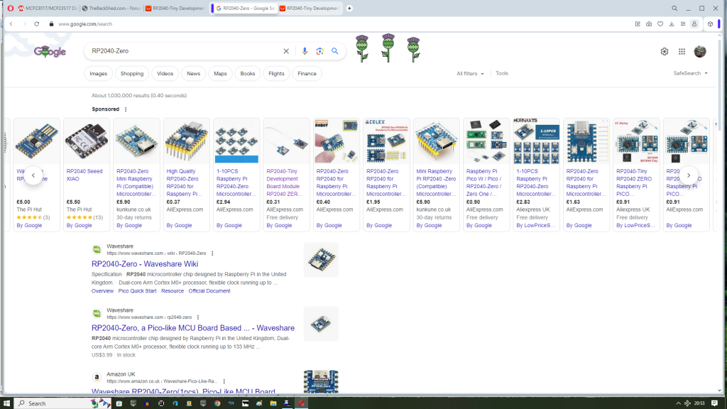

  Mixtel90 said  I've been using a RP2040-Zero as an I2C expander for a controller (I'm just doing a hardware prototype at the moment). It has a lot of advantages. I can program a cheap analogue joystick module as either analogue X-Y or as digital by using the PicoMite as comparators. I can also change the I2C address under software control! :) Pretty cheap from AE too.
https://www.aliexpress.com/item/1005005533904456.html?

This style Stan.
