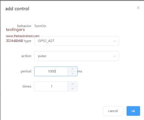

I assume you've already solved the issue with the speech recognition modules. Nevertheless, here's my experience with the Ai-Thinker VC-02 module.
Firstly, I want to clarify: I do NOT recommend the module due to several drawbacks. However, it is inexpensive. It costs just 5 EUR (AE) complete with microphone and speaker. The microphone sensitivity is sufficient, and commands can be easily given and recognized from a distance of 3 meters or more.

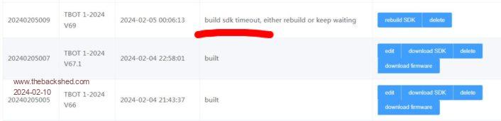

The biggest disadvantage lies in the poor and inadequate documentation. It's mostly in Chinese, and unfortunately, many functions are not explained ("automatic study commands"?, I2C ? wake up button ? ...). Another drawback is that compiling the firmware via the web interface typically takes 30 minutes and sometimes unexpectedly fails.
In addition to a poorly or undocumented SDK, there's the option to create firmware for the module using a partially dysfunctional web interface.
Registration is required here:
http://voice.ai-thinker.com/#/

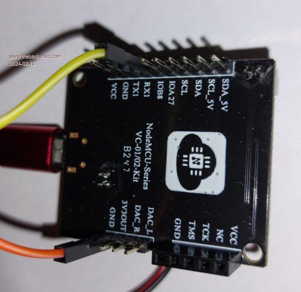

Typically, five GPIO outputs can be linked with a single command (in English or Chinese). A command can control multiple outputs:
GPIO27 = GPIO PIN
GPIOB2 = SCL, Cold light, (GPIO PIN!)
GPIOB3 = SDA, Warm light, (GPIO PIN!)
GPIOB6 = RX1 (GPIO PIN!)
GPIOB7 = TX1 (GPIO PIN!)
Additional pins
GPIO25 = blue light
GPIO26 = "wake up" button
Not accessible from the web interface:
GPIO28 = -- PA chip enable control pin - don't use!
GPIOB0 = - don't use!
GPIOB1 = - don't use!
GPIOB8 = - log ?

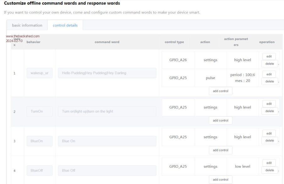

It's possible to configure these GPIO pins as high/low or as PWM via the web interface. The commands can be in natural English, as well as the confirmation.

There are two operating modes: Wake state and wake-free operation. To activate the wake state, a keyword must be specified (e.g., "Hello Pudding" or something similar). The wake state lasts for a specific, adjustable time (up to 60 sec) and then switches off. For wake-free operation, up to ten commands can be specified.
The module works well for me now after taking a few days to understand and test everything.
  Grogster said  I really only need ONE voice command, as I just need a simple on/off switch, ideally setup as momentary - if the module recognizes the voice command, it trips the relay for about one second, then releases it and goes back to listening again kind of idea.
I believe it would be suitable for the intended purpose.
The reliability/selectivity is good and I have not encountered any unwanted activations.
The module can be programmed directly via the (micro) USB port.
Operation of the burning program (UniOneUpdateTool.exe):
Press the lower button to select the Com port (yellow when the port is online).
Select the file to burn (uni_app_release_update.bin).
Then press the reset button on the vc-02 development board.
The progress of the transfer is displayed in percentages.
