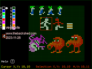

Over the last week or so, I've bashed together Simple Sprite Draw to assist with my sprite creation.
Martin posted a nice sprite editor a while back but his didn't quite suit my needs.
The main feature is a workbench upon which you can scribble all manner of things, of which only a selectable smaller region is used for generating the actual CSUB sprite data. Coupled with this is the ability to perform simple frame animations to test animated sprites. CSub data is sent to the console (Teraterm, for example) for cutting and pasting into MMBasic source code.
I've included two workbench saves. Put the .BAS and the two .TXT files together on your PicoMiteVGA somewhere. Run SpriteDraw01R.bas from there. Open TestSprites.txt to see the above image. (Use the help menu to learn the keys for moving the cursor and the selection region around, resizing, etc.)
(Yupp, yellow is a bad colour choice on a white background)
For an animation example, open Lemmings.txt and set up as follows:
1) adjust the selection region to be 8 pixels wide and high,
2) shift the selection region to enclose the top left lemming image,
    Selection X,Y: 0,8  H,V: 8,8
3) Press F4 to clear any limits,
4) Press F5 to mark the starting limit,
5) Press F7 seven times to get to the last image (of 8),
6) Press F8 to mark the ending limit,
7) Use F6 and F7 to step backward and forward through the image sequence and watch
    the little fella walk along in the real view box. The sequence loops at the end.
Do similar to view the pick-axe sequence.
I'm using this via a PC and Teraterm. Hopefully is works correctly for other setups.
Notes:
- Cut, copy and paste are not implemented yet, due to memory issues.
- The ability to load other source images could be added, if there's a demand.
- At present, only uncompressed CSub data is generated.
Have at it and enjoy. Let me know your experiences, bugs, etc.
