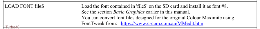

I Think you need 'LOAD FONT file$'.
The Manual says:

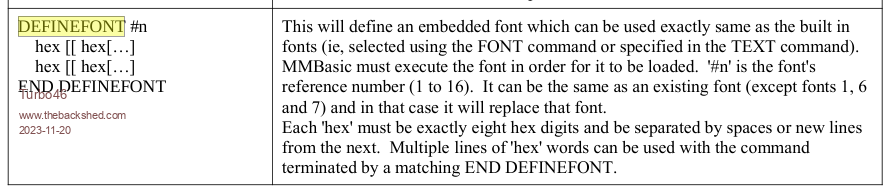

Or Definefont:
