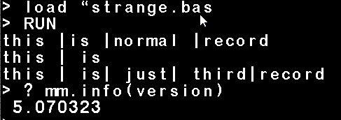

@Peter,
It seems there is some problem. While reading text file (printscreen 03b23, tested also on 03b24 )
It does not input line if meets coma ->> ,
Please check attachement

Posted: 09:02pm 05 Feb 2025
Use LINE INPUT if you want the full line including any commas

  TassyJim said  Use LINE INPUT if you want the full line including any commas
Thanks! Line input works. And now i see already about comas in user manual explanation.
I read manual like a bible. However cames out, not accurate enough
