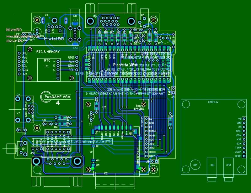

I drew the circuit yesterday but then had an idea... should I incorporate the VS1053 module instead of the MCP48x2 chip? To do that there would be compromises, I think:
If a plug-in Pico or a YD-RP2040 was to be used then a microSD card would be needed.
To keep the full size SD a surface mounted Pico would have to be used.
Personally I rather like the idea. I would like to be able to keep a plug-in Pico module though - without going over a 100x100 PCB. It might be worth the effort.

Yes, it fits. :)
Same PCB size and case.
VS1053 audio
Optional PAM8403 stereo amplifier (you need to sort out your own sockets & volume control)
Standard size SD card socket
Single DB9 controller socket
Handles one WII controller or one NES/SNES controllers
RTC
Plug-in Pico or YD-RP2040 or a surface-mounted Pico

Obviously some sort of adapter is needed for a WII controller. There is no PCB space for a socket.
An adapter is needed if two NES/SNES controllers are used. They have separate Latch signals.
Latch1 and Latch2 are ADC inputs so, in theory, a X-Y analogue joystick or two paddles with two buttons each could be used, but detection isn't automatic.
Edited 2023-11-21 07:59 by Mixtel90

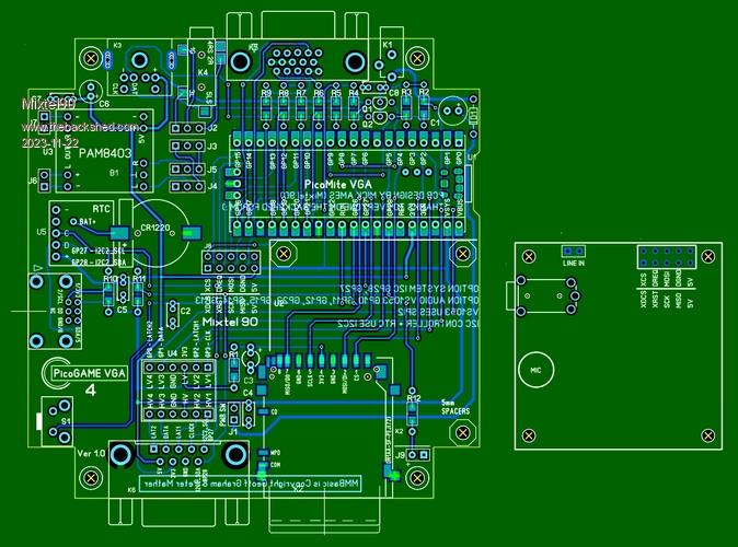

Posted: 10:29am 22 Nov 2023
There's a layout now. Circuit not quite right at the moment.
I've squeezed a WII controller socket in on the LH side but it's dimensions are intelligent guesswork as I can't find a drawing and I've not got a controller or a socket. The enclosure wall may be too thick, requiring quite a large cutout. The I2C connections appear on the D9 connector as well as here.
The VLS1053 is connected using a female-female Dupont loom or something similar. Audio can come from the jack or from wires tacked on underneath. They connect to either J2 (direct output) or J3 (via volume control to PAM8403). A volume control pair can be plugged into J4 and J5 but I'm not sure where you could mount it. The VLS1053 is mounted on 5mm spacers but only 3 can be used as one corner is over the top of the SD card socket.
Resistors can be either through-hole or 0603. The Pico can be surface mounted or plug-in. A YD-RP2040 can be used instead.
When the RTC battery goes flat take it off, connect the BAT+ wire to it and fit a CR1220. :)
GP26 was left so I connected it, via R12, to a socket near the front for an LED mounted in an awkward spot over the fixing screw. :).

Posts: 6054
Posted: 08:24am 23 Nov 2023
Why not place the VLS1053 connector such that you can plug the board directly on top?
(upside down), preferably so that the audio connector and SD card and controller interface connector are in the front panel.
Edited 2023-11-23 18:25 by Volhout
Posts: 9082
Posted: 08:47am 23 Nov 2023
I seriously considered that, and I think I could do it. However, I've not got one and I can't find a drawing that gives the connector position (or anything other than the overall size). There's no chance of getting stuff on the front panel unless I get rid of the D9 connector. I could get the WII connector next to it, or a 6P6C RJ. TBH I wouldn't mind doing that. ;)

There is the other  version of the VS1053 which is available at a good price and has an "easier" header. It has a SDcard on the bottom which we can't use as it connects to the same SPI as the VS1053 but it can be ignored
Posts: 9082
Posted: 09:30am 23 Nov 2023
Thanks Peter, I'll try that. It looks as though it might be easier. No-one seems to give even an overall size though. lol
EDIT:
It looks like this one will fit. Jack sockets on the front. Took the amp and stuff out as it's no longer needed - this seems to drive headphones or a line out. Managed to keep the D9 connector on the front too.
I'm assuming that the CS pin will be for the SD card, so not connecting that. You can't get to it anyway.
