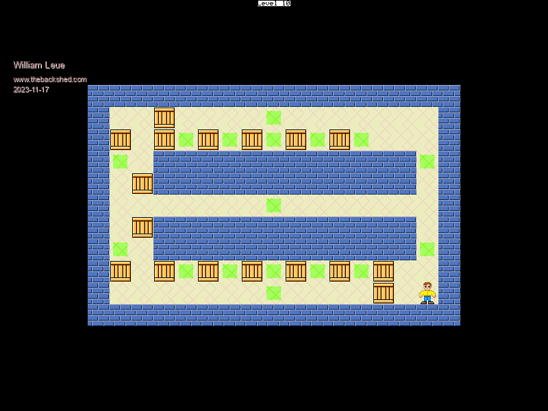

Some time ago (years) vegipete posted the game "CrateAway", a Sokoban-type puzzle game that had several puzzle levels integrated into the game source code.
This game can also load additional puzzle levels from standard Sokoban data files, which are text files that use various punctuation characters to stand for walls, floors, and various movable objects.
I recently wrote a level editor for CrateAway that lets you create your own levels. With vegipete's blessing, I am posting the level editor with a Sokoban data file I created using the editor called 'HardLevels.sok'. These new levels are indeed hard!
Because vegipete's original posting of CrateAway seems to have disappeared from TheBackShed, I include it along with the new LevelEditor program.
Enjoy!

Oops! I found a mistake in Level 1 of the HardLevels.sok Sokoban file: I had
accidentally omitted a goal that was hiding under a crate, so that level could not be solved. Here is a replacement with the mistake fixed.
