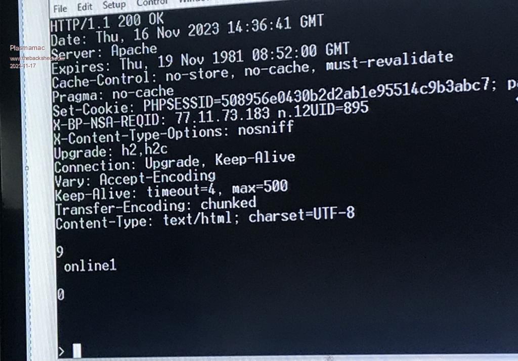

Posted: 01:20pm 16 Nov 2023
I wish all bugs could be found & fixed so quickly!
Plasmamac
Joined: 31/01/2019
Posts: 620
Posted: 02:53pm 16 Nov 2023
Thx a lot
Works like a charm
Plasma
