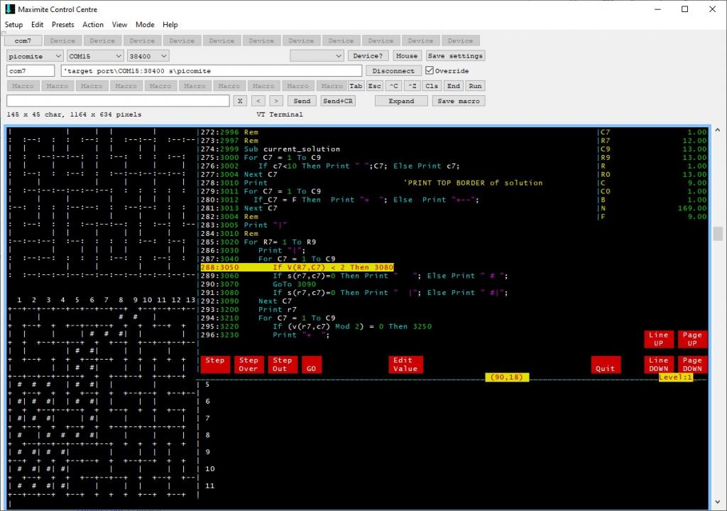

Below is a screen shot of the modified Amazing.bas program running with MMDebug in control.   You can see one of the modifications where this version of Amazing.bas is displaying the solution to the maze after the actual maze is printed.   During the print out of the solution I pressed Ctrl-D and MMDebug woke up and took control.
The purpose of this section of the post is to identify the different areas of the MMDebug screen and how they can be used.    At the bottom various command buttons are available.   A simple mouse click on the button performs the function specified.   In the far bottom right of the screen is a status area telling you how deeply the program is currently nested into subroutines or user defined functions.  In the upper right of the screen are the most recently seen variables.   This is the ‘Watch Area’ of the screen.  A variable with a Red value has just changed value.    On the left side of the screen you can see a line highlighted in Yellow and Red.  This is the current MMBasic statement that is about to be executed.    And on the far left are white numbers.   These are the actual MMEdit line numbers of the program.
Two different capabilities are present that are not handled by the command buttons.   If you click on a White line number, a Break Point will be set at that location and control will be relinquished to MMBasic until that statement is next to be executed.   If the variables in the upper right side of the screen do not include a variable (and value) you need to see, you can click on a line of logic that has the variable you are interested in.  You might have to Page-Up or Page-Down to find a line of logic with the variable you are interested in.   But when you click on that line of logic any variable that is currently defined will be placed at the top of the ‘Watch Area’.
A few words about the Step commands will be helpful to you.   Step does just what you would expect it to.   It will execute one statement.    Even if there are multiple statements on the same line, Step will do one at a time.    Step also loads any currently defined variables for the current statement into the top of the variable ‘Watch Area’ of the screen.
Step-Over steps much faster than single stepping.   Step-Over sets a break point at the start of the next line of code independently of how many statements are on the current line of code.  But Step-Over also steps over For-Next loops and Do-Loops.   If you Step-Over a For or Next statement, the entire loop will be completed and control will be given back to MMBasic at the logic line immediately following the Next statement.   The same applies to Do-Loops.   If Step-Over is done when the Break Point is on a Do or a Loop, the entire loop will be executed and control will be given back to MMDebug at the statement immediately following the Do-Loop.    Lastly, Step-Over can be used to quickly execute entire Gosub’s , Subroutines,  user defined functions and Select Case statements.  Please note that if you have a spaghetti program that arbitrarily jumps out of For-Next or Do-Loop’s, you will lose control and have to press Ctrl-D to get control back.
Step-Out is conceptually much like Step-Over except its purpose is to help you get out of functions and subroutines.   You do not need to step repetitively to get out of a subroutine or user defined function.  You just Step-Out and MMDebug will take back control at the statement following where the function or subroutine was invoked.
Lastly, Edit-Value needs to be discussed.   With a character orientated display it is very difficult to display elements of a large matrix.   This fact combined with the need to easily display variable values that are not in the ‘Watch Area’ necessitates the Edit-Value command.
The Edit-Value command actually uses MMBasic’s ExecuteProgram() function to do its work.   At the command prompt you can enter either a Print statement or a Let statement depending upon whether you want to see a variable’s value or change a variable’s value.
For example, at the prompt in the Edit-Value command you could say > Print xyz .   If xyz has been defined it will print the current value.   If you wish to change the value of a matrix element you might type something like > Let MM(R+1,C-1) = 10.2      You can use normal MMBasic syntax and index into arrays using current variable values.
If what you type has a syntax error in it, MMBasic will complain about the syntax problem and report the current line you have MMDebug break pointed at as the line that caused the problem.   Of course, this isn’t strictly true.   The line you are break pointed at is probably fine, but MMBasic doesn’t know that.    If MMBasic complains about a syntax error, MMDebug will yank control back from MMBasic
Pressing an empty Return when in the Edit-Value window will terminate and close out the window.  If you ask the Edit-Value window to display the value of a variable, you can just type Print (or ?) to reset the window and look at another value.    The important point to understand is an empty Return gets you out of the Edit-Value window.

Yes.   Moving the display window to a given line of code is also almost trivial.   The hardest part of doing this is deciding on the way for the user to specify where they want to move the window.   And perhaps it should allow multiple ways to enter that information.   It could be a hard number of lines from the start of the program.   It could be a given label or line number (for programs that use line numbers).  It might be that the first couple of clicks move the window 20 lines but subsequent clicks start moving more and more lines at a time.   Doing what you suggest is actually very easy to do.
Would typing in a line number be a good way to position the window?   Alternatively, a new button at the bottom could be added to query a position from the user.

How about a pseudo-command in a comment? Something like
'TRACE
starts the list. It could even be temporarily commented out with
''Trace  :)
It could be extended
'Trace 30
to list the next 30 lines.

Personally I would be happy with a way to erase a selected variable or even the whole watch list, both ways would do, the simpler to implement.
And I would prefer entering an absolute line number as the pointer to the debug code zone, I would not like to  have to edit my code with debug commands.
