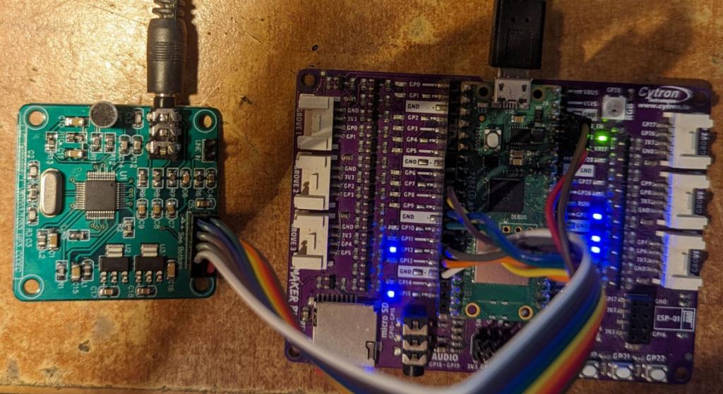

Hardware requirement
1 PicoW
1 VS1053
9 Dupont connection cables
Software requirement
Peter and Geoff's magic WebMite MMBasic V5.07.08RC15
WebMiteV5.07.08RC15.zip

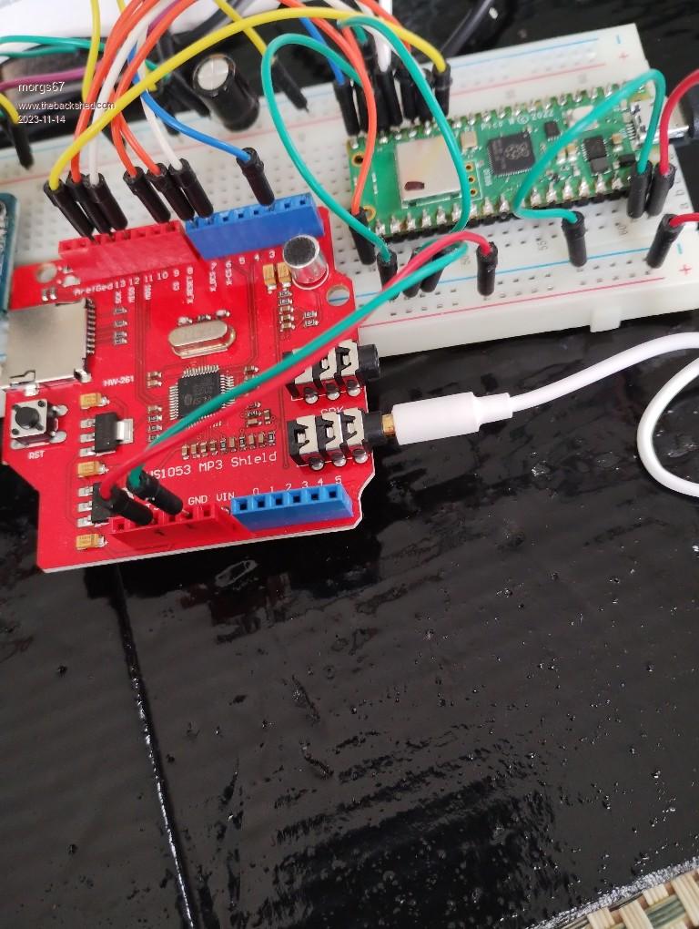

Posted: 07:23am 14 Nov 2023
Tried with a Arduino VS1053 shield similar to Geeetech one.
Works fine.
Tony
