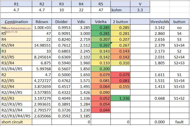

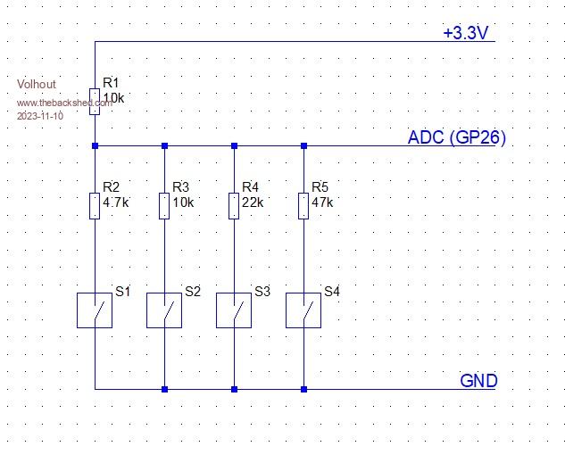

Posted: 08:38am 10 Nov 2023
I think it is do-able to decode 4 keys with one ADC input.
With following circuit.
This will give you 80mV minimum resolution for 2 key press detect (change R1 to 4.7k). This is in the "2-button" column in the red fields (0.080 = 0.080 volt = 80 milivolt)
Result from following analysis:
And a small (not tested) MMBasic program to show how it works.
You scan through the voltage levels in the array, and see where the ADC pin voltage crosses a threshold.

You can extend this of coarse to 5 or 6 swiches, but you may have to calibrate the ADC, and add averaging and noise filtering. Since (as you can see in the analysis) there will be very small steps you need to detect. The ADC resolution (4096 steps for 3.3V) has a 1mV resolution, so technically 6 buttons is possible. You may need precision resistors in non E96 values to get sufficient accuracy.
