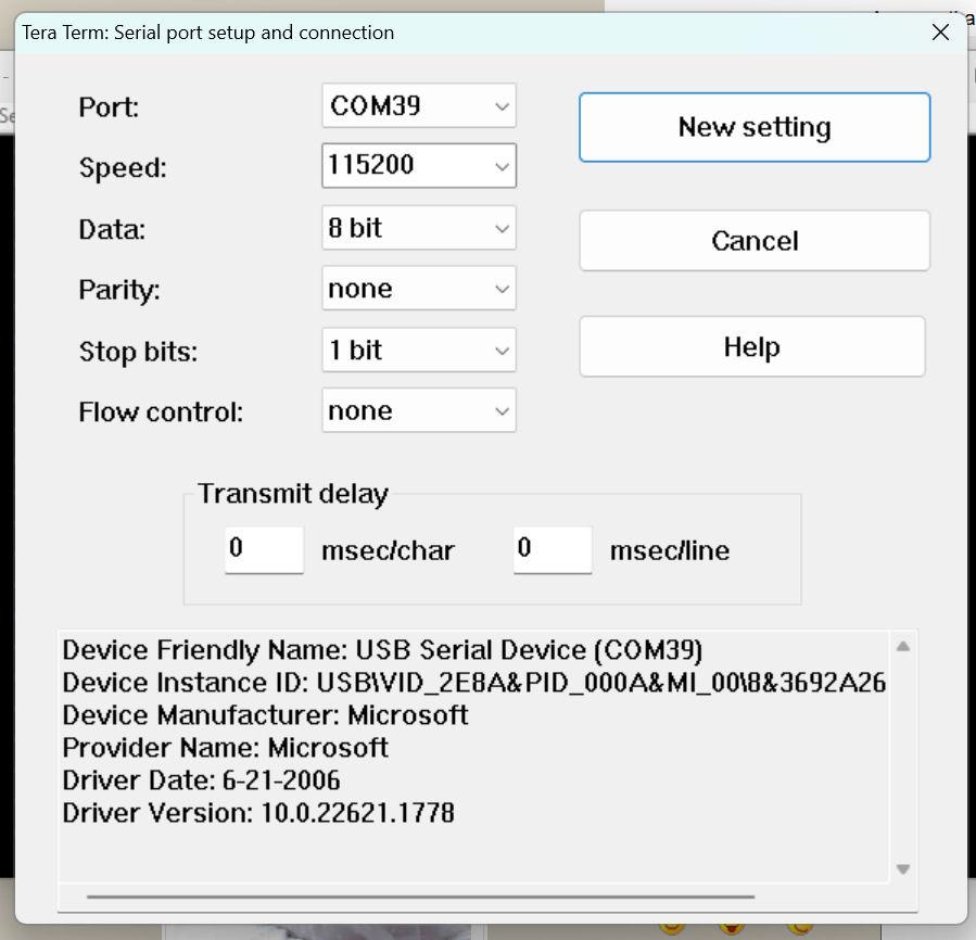

I see that problem consistently, which has made my workflow a bit different. I generally first edit on Notepad++ or Atom (both have nice syntax coloring, and use familiar Ctrl-C, Ctrl-V, Ctrl-Z keystrokes), then use XMODEM to transfer the file to the Pico.
At that point, it hardly ever runs correctly first time, so I clean up problems in the built-in editor, exit/save, to a LIST ALL, copy that to the TerraTerm clipboard, and paste it back into the Notepad++ session, and from there up to GitHub.

No joy, even with a transmit delay of 5 msec/char. I'll stick with my workflow.

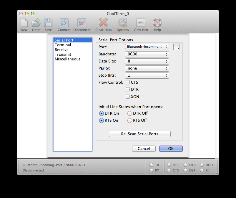

the following may or may not be the cause of your problems...
be sure to set hardware flow control to NONE. the pico also requires that DTR be ASSERTED. this has been an issue since the pico was fist released, and as far as i am aware has not yet been fixed in tinyusb. use google to search for:
pico tinyusb DTR
you could try and find out if your terminal emulator enables asserting DTR manually while hardware flow control is set to NONE. some do, others don't.
rob   :-)
