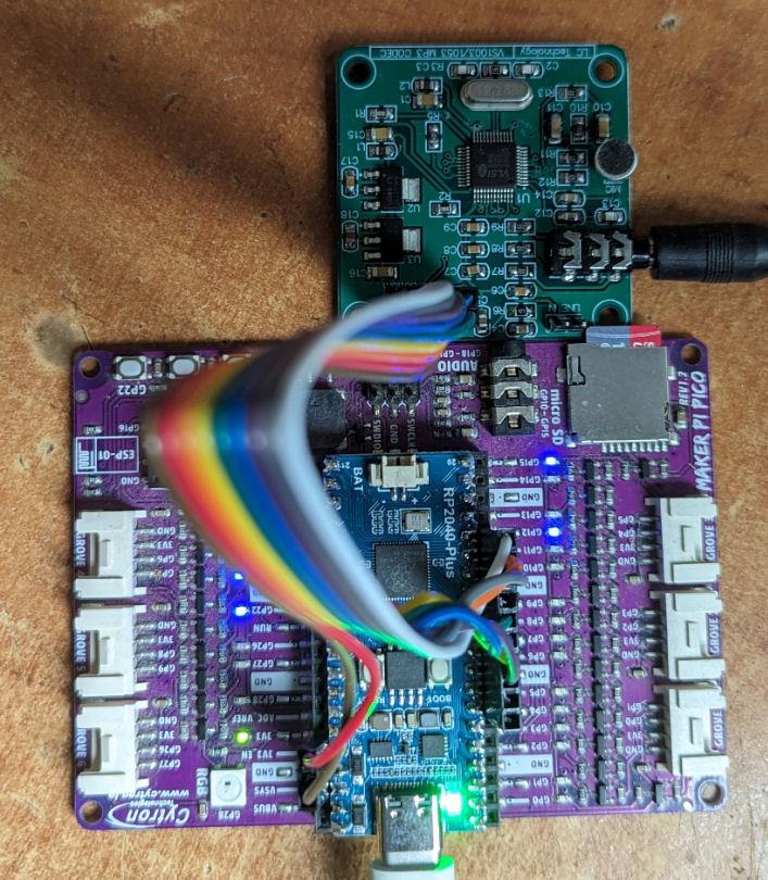

I've been playing with the VS1053 module from LC (this one )
So far I've managed to get it playing back mp3, flac and wav files from SDcard with, of course, better audio quality than the native PicoMite audio.

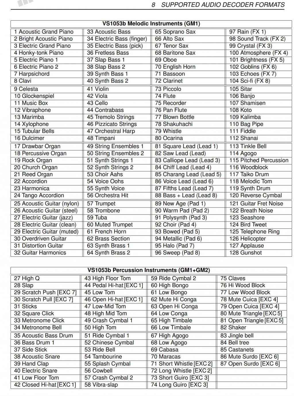

In addition I've got it supporting real-time midi. i.e. you can send it the various midi instructions (note on, note off, channel, etc.) and it will interpret them. The chip supports a maximum polyphony of 64, and the maximum sustained polyphony is 40.
the instruments supported are as below.

Should work but no promises. The issue is that connections to the VS1053 I/O pins configure how it behaves on boot. My code overrides these default configurations but I can't guarantee that I've caught them all. Hopefully I have as the board I picture is known to have an unusual default configuration which I had to override to get it to play mp3 etc.

I have the same configuration
MAKER PI PICO card
Pico 2040
sound card as your (gp9,gp8,gp7,gp6)
PicoMite MMBasic Version 5.07.08RC20
OPTION SDCARD GP15
you wrote
NB: OPTION SYSTEM SPI must be set up and wired to the MISO, MOSI, and SCK pins on the module
NB: OPTION AUDIO does not need to be set to use the VS1053
NB: maximum CPU speed for this module is 252MHZ
for that I send midi command and I receive
> play vs1053 gp9,gp8,gp7,gp6
Error : Audio not enabled
if I put option audio, I receive that
> option audio spi gp9,gp6,gp7
Copyright 2011-2023 Geoff Graham
Copyright 2016-2023 Peter Mather
Error : Unknown command
where I make mistake ??

Joined: 12/04/2017
Location: France
Posts: 435
Posted: 04:44pm 20 Nov 2023
> option list
OPTION SDCARD GP15
> option audio vs1053 gp10,gp11,gp12,gp9,gp8,gp7,gp6
Error : Pin 14/GP10 is in use
Edited 2023-11-21 02:48 by goc30
Posts: 12071
Posted: 05:01pm 20 Nov 2023
From the referenced post
  Quote  Note that like the MCP4822 the VS1053 uses a separate SPI port from that specified by OPTION SYSTEM SPI. A dedicated SPI channel is essential to allow it to be used in a H/W interrupt routine.
goc30
Joined: 12/04/2017
Location: France
Posts: 435
Posted: 05:03pm 20 Nov 2023
You wrote at the top of this page
and on yours pictures VScard is connected on the same SPI as sdcard
Edited 2023-11-21 03:05 by goc30
Posts: 12071
Posted: 05:20pm 20 Nov 2023
Yes but this thread refers to an experimental test version. As always the final version will be in the release candidate thread and documented there.
goc30
Joined: 12/04/2017
Location: France
Posts: 435
Posted: 06:00pm 20 Nov 2023
now it work
> option list
OPTION SDCARD GP15
OPTION AUDIO VS1053 GP2,GP3,GP4,GP9,GP8,GP7,GP6', ON PWM CHANNEL 1
> play mp3 "b:track0002.mp3"
pb of doc not very clear
