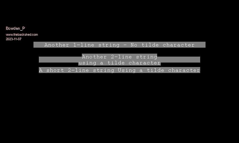

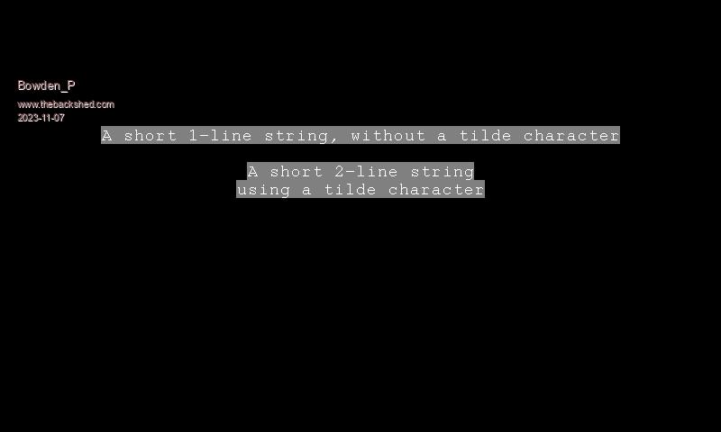

Further to a previous post, please could a guru look at this potential bug. When a string with a Tilde in a GUI CAPTION control is changed, it appears that the erase of the old string ignores the "~" character, treating it as just another character.
Please look at the screen grabs below. I have also included the listing that generated the screens.
The screen before the string change :-
The screen after the string change :-

text 400,235,"A short 2-line string Using a tilde character",CM,,,rgb(white),rgb(gray)            ' Original Tilde string for comparison,
'save image "After String Change.bmp"                                                             'but with a space instead of the Tilde.
