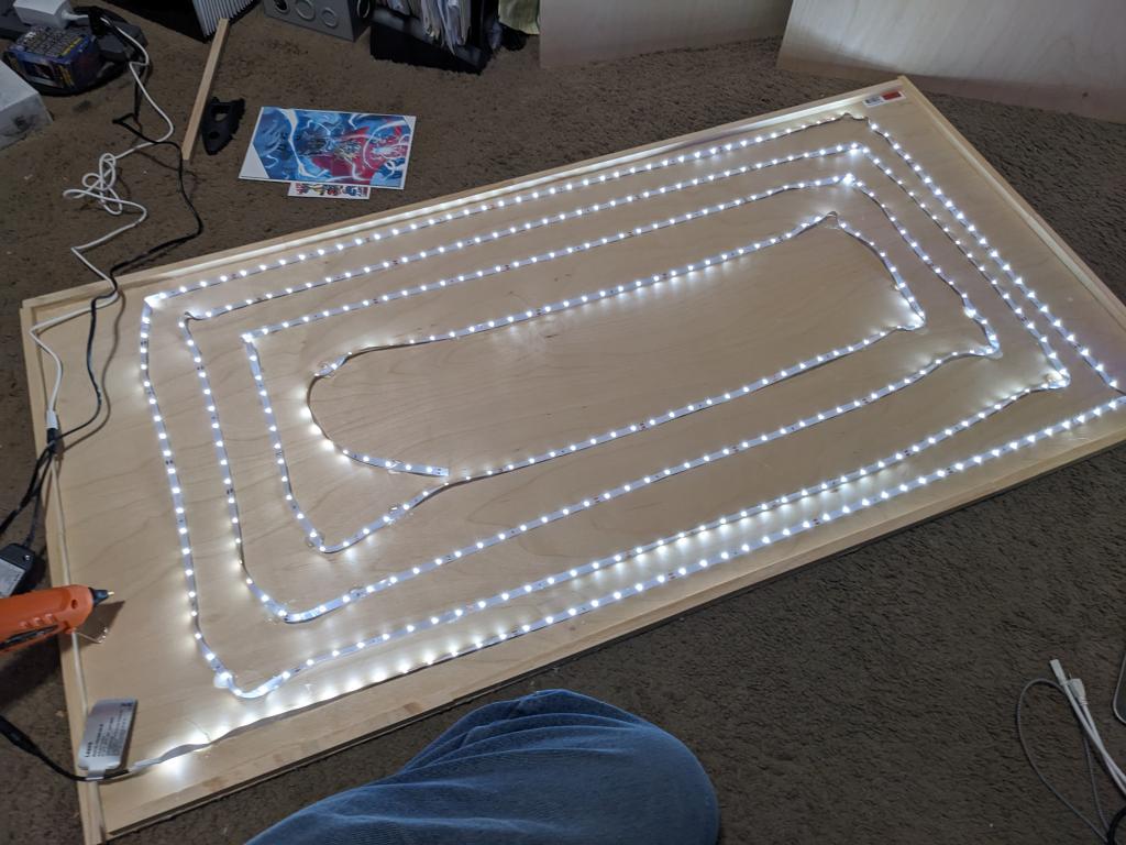

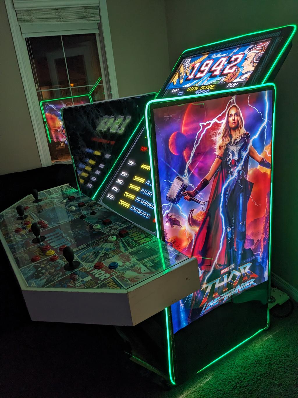

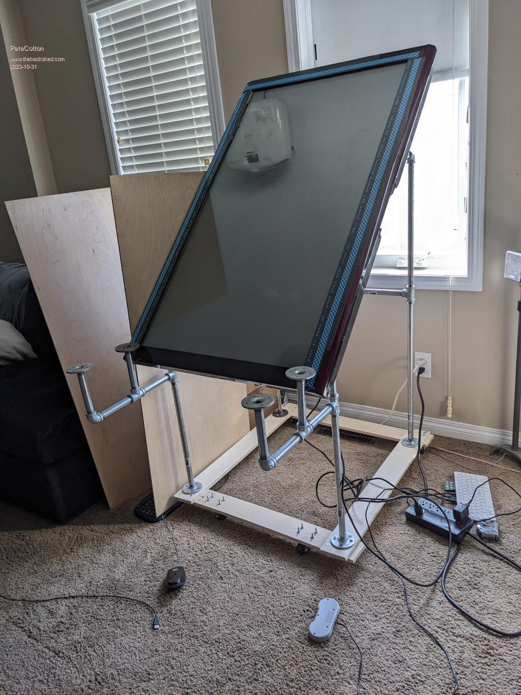

Having been left unsupervised for a week, I've been tinkering, and I thought you guys might appreciate it.
As many of you know, I've always been a bit of an arcade buff, building cabinets and the like. I got the idea of using 1/2" steel pipe to make the frame of a cabinet - so that it would be light and rigid. I also re-used a really old (and heavy) 55" plasma TV that's been languishing in our basement.
Then to make a couple of back lit side panels using extra bright LEDs.

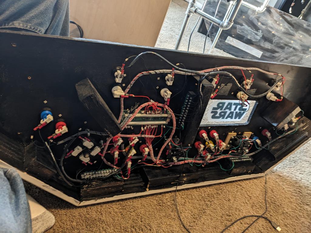

And then re-wiring an old control panel I built years ago. This has an Ultimarc I-PAC 4 keyboard encoder at the heart of it. It's a bit long in the tooth now, but still works great. Takes a bunch of digital inputs and converts them to USB keypresses.
https://cdn.shopify.com/s/files/1/0008/4262/9179/files/I-PAC_4_Player_Card_Wiring_Diagram.pdf?v=1600300277

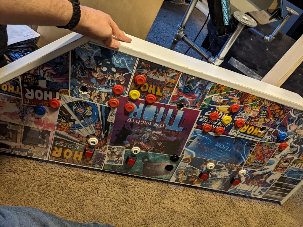

The old control cabinet was Star Wars themed - so I refreshed it with a Thor based theme by buying a bunch of Thor Comic PDF's online and printing out the frames that I wanted.

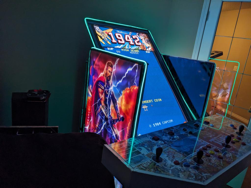

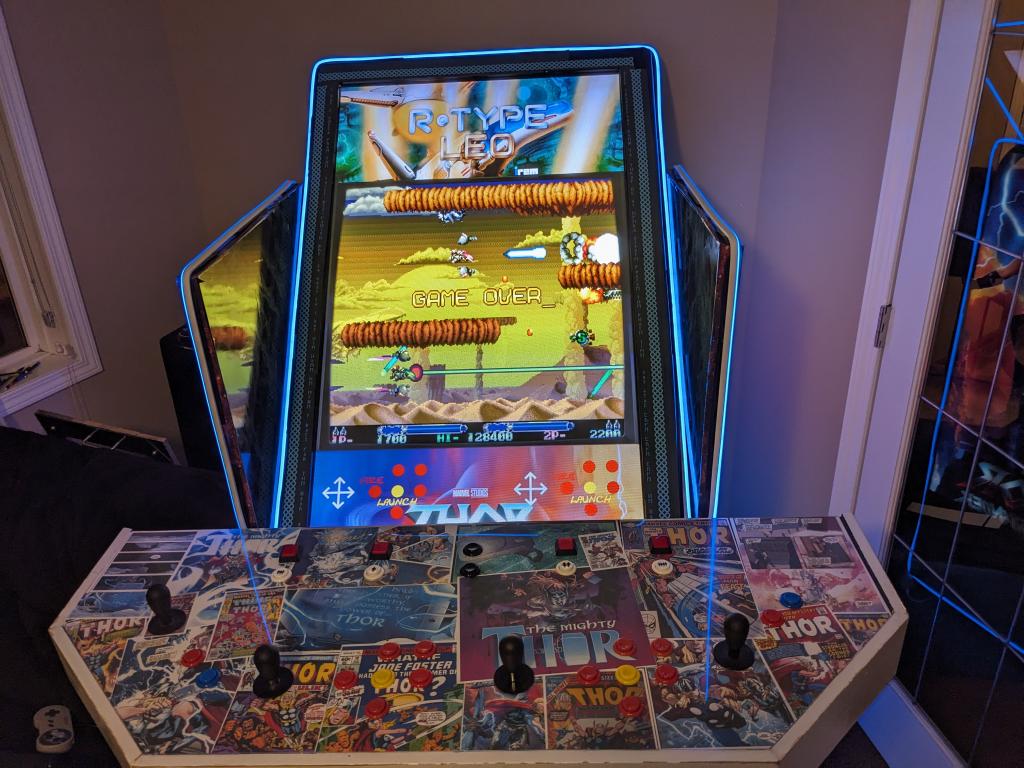

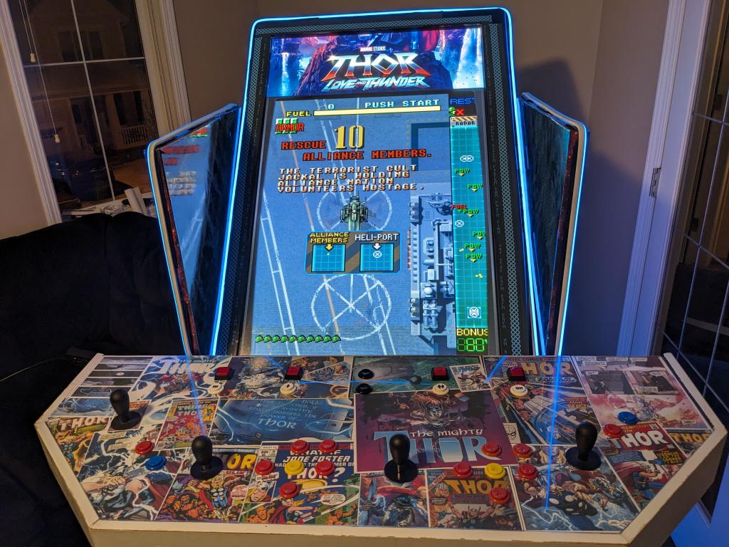

I put a Raspberry Pi 400 in as the brains, and bought some original Thor movie posters (printed both sides) for the side panels and here is the end result.
