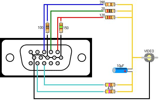

A "easy hack" could be something like this, (at a very basic level).
mixing all signals with a handfull of resistors would give you some kind of Grayscale Composite Signal, but I couldn't say, what the timing looks like and whether the television can process it.

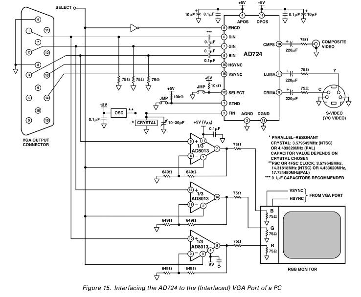

This circuit looks more promising. Using a AD724 RGB 2 PAL/NTSC Video-Encoder
(That could be what is built into the converter that Grogster linked)
You can do without the lower part and the S-Video of the circuit if you don't need both
found here
