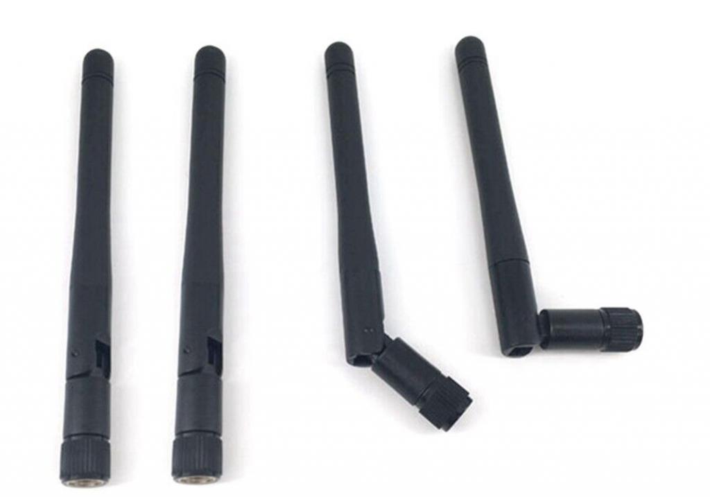

I am looking to get some 433MHz antennae, those short rubbery black ones that pivot in all directions as well as folds down when not in use.
Looks like this one.

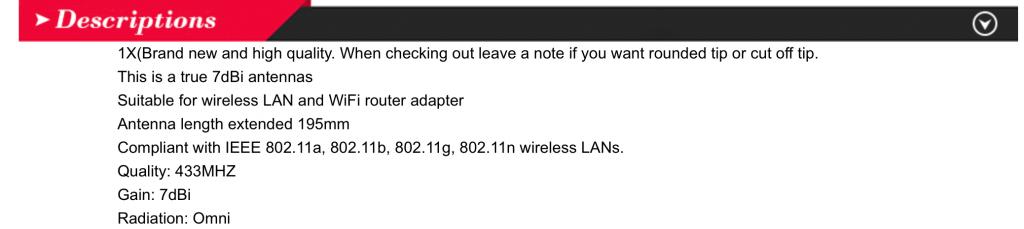

But reading the specs confuse me and I am wondering if some sellers are falsely advertising their products (shock horror)
For example here are the quoted specs.
Note that they say suitable for wireless lans.
Aren’t wireless lans 2.5GHz or 5GHz? Some even state these as well as 433MHz in their specs.
I wouldn’t have thought that the antenna could be optimised for all of those frequencies.
Or am I wrong in that assumption?

Probably almost as effective as 6" of wire pushed into the socket. :)
They state 7 dBi (gain of 7dB relative to omnidirectional) so these are obviously directional yet they are also omni? Lovely new invention!
The cavalier attitude to resonant frequency is merely icing on the cake. :)
They do look like the ones normally supplied with wifi LAN cards and routers.

I'm not sure if it's exactly what you want - but I did a bunch of research on various antennas recently (sorry I can't share the raw data - it was for a client). However, the consensus was that yes - the cheap antenna are absolute garbage. One's marked for 433MHz where actually 915MHz etc.

Mick, I have tried using this type of antenna in the field and I think the gain should be expressed as 0.7 dBi and the SMA connector should not be reversed as in a WiFi antenna.
Unfortunately the antenna did not stand up to the wildlife and the birds dismantled them to reveal that they only consist of a length of wire in a plastic tube.
I replaced them with stainless steel whips and in cases where I needed more gain small yagis.
Hope this helps

Thank you for the responses, it seems that I was correct with my suspicion that these sellers are taking us for fools to suggest the antennae can work (and perform) on bands as far apart as 433MHz and 5GHz.

Thank you for all of the advice, it proved that what I thought about the online sellers on Fleabay was correct and they were effectively lying about the specs of their antennas.
