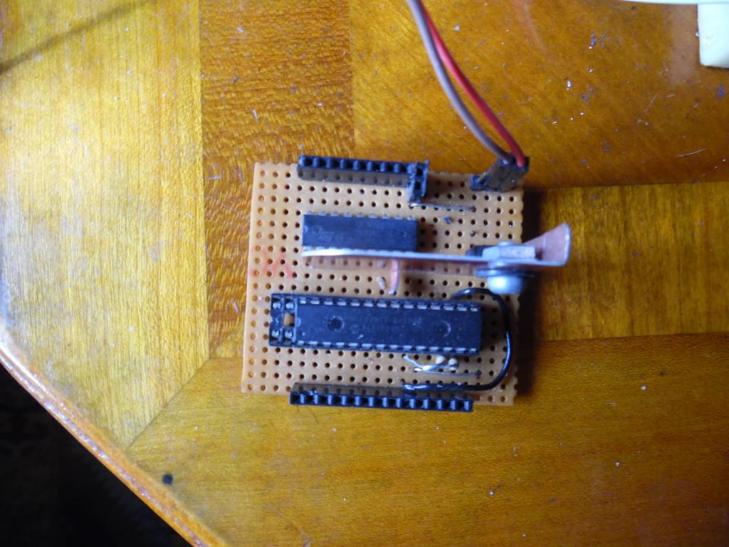

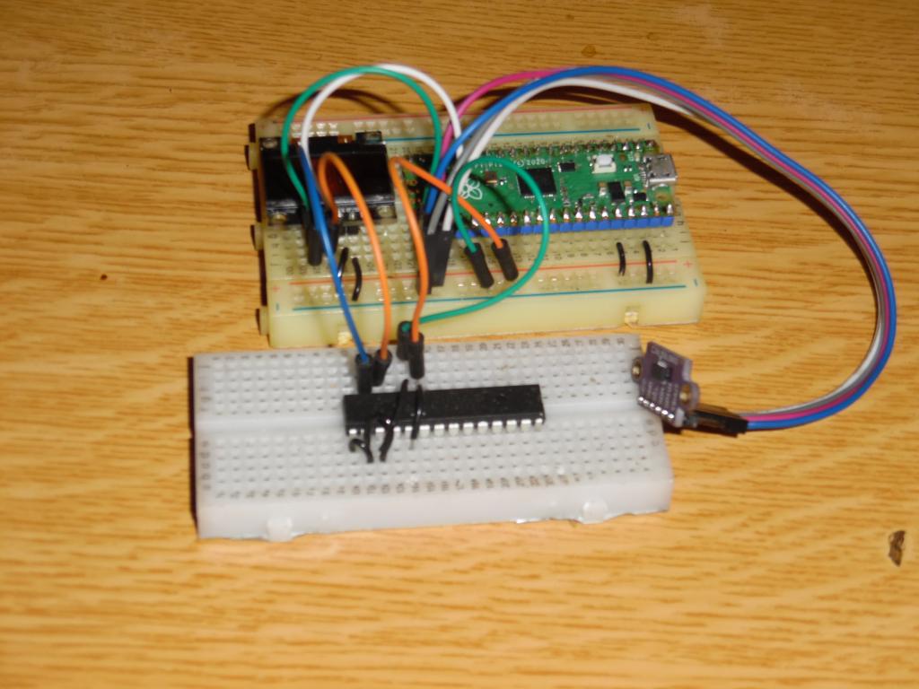

Thanks lizby. Turns out I bought 5, I found the tube with 2 in. The other is on breadboard, the other in a robot and the other on stripboard ready to replace the one in the robot with dual uln2003 not the boards with leds that come with the motors.
