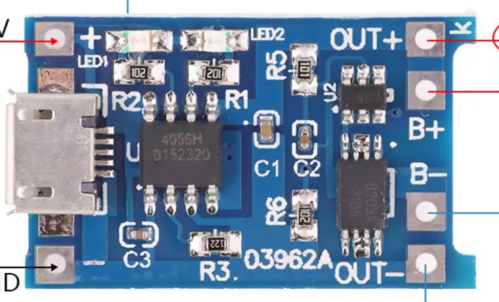

Mick, All,
I have had a look and I agree they are set for 1A charge (which is way too much for the one I just made with a 280mAh Lipo)
The good news it is the easiest resistor to change. In this image it is R3 on the bottom row of the board.

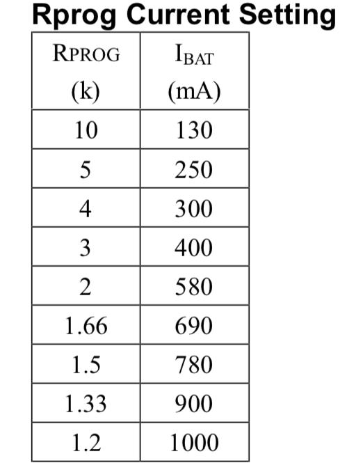

To change the charge  rate, remove this resistor (not difficult, heat both sides with a hot soldering iron then hold one side and it will move away easilly enough) and replace with the correct value (if you are OK with SMD work).
If you are not confident with SMD work a small 1/4W resistor can be soldered from the left hand side pad of where R3 was removed from to any GND point, I suggest the large - pad at the very left hand bottom corner of the above image.
Use this table to select the desired charge rate, which if isn’t known is generally half the rated capacity of the battery, ie 1000mAh battery should be set to charge @ 500mA.
It looks like it should be a fairly straightforward rework.

Interesting, I'll put a 1.2k resistor in series with a 10k trimmer on my design and possibly a shorting link which can be open for non-rechargables
Posted: 02:09pm 22 Oct 2023
So if you are charging a 1000mAh battery @ 1 mA (1.2k resistor) are you in the "hmm, you'll get away with that but your battery won't thank you" region or the "running around the house with your hair on fire" region ?
Do you need to use these discrete values or can I pick from standard sizes and use a 2.7k resistor for this size of battery. And am I correct in thinking it looks like an 0805 ?

You recommend a 1000mAh battery, I would suggest to leave the TP4056 as it is.
If you want to set to a ‘safer’ charge rate of 0.5C or 500mA, from the table above (taken from the TP4056 datasheet) this would be achieved by using a 2k2 resistor (yes it appears to be a 0805 size).
