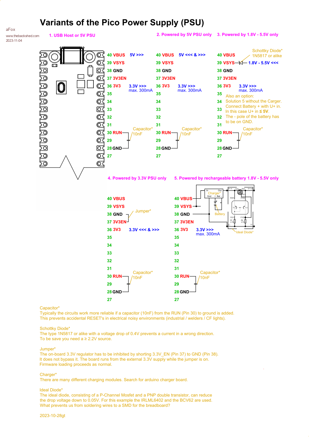

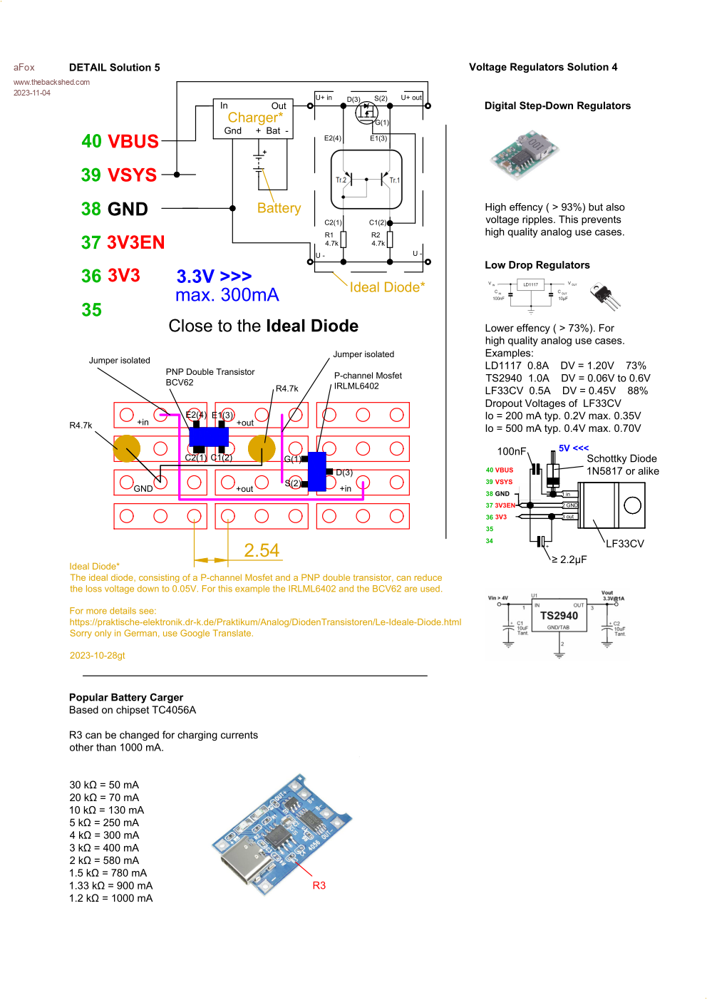

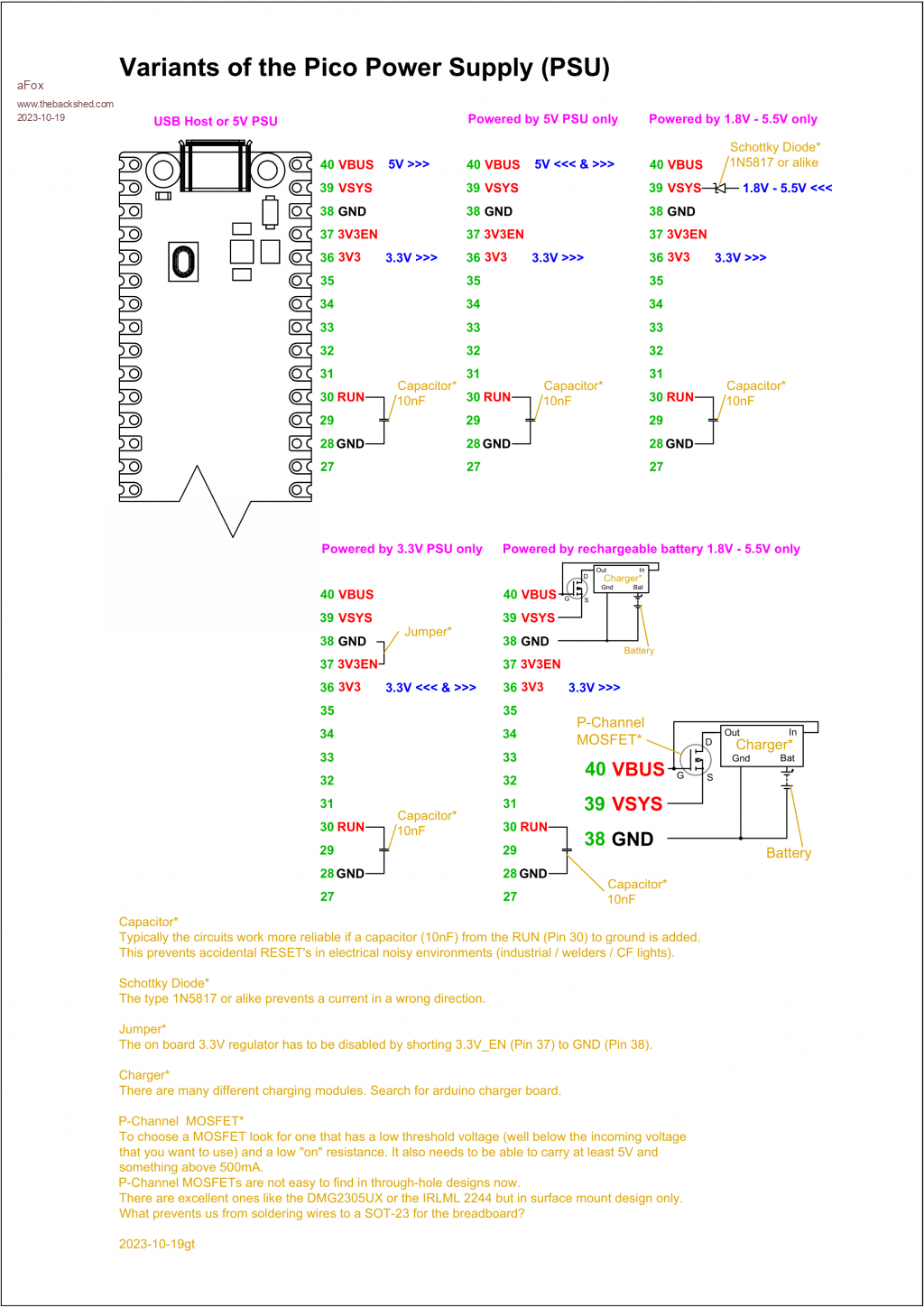

Hi
Many thanks for your support.
Here is the result.
In conjunction with an ESP32 I got the suggestion to use the P-Channel MOSFET
IRLML 2244. Whould be nice if someone could check the datasheet.
Does the P-Channel MOSFET need any resistors?
Suggestions are welcome.
Gregor

No, you don't have to have resistors for the MOSFET.
When powering via VSYS the external Schottky diode is only needed if:
a) The external supply is a battery, in which case it prevents it from being charged by the 5V USB input. Note that VBUS is directly connected to the USB 5V rail.
or
b) The external supply normally has a lower voltage than 5V. It could be from, say, a 3.3 regulator that is part of another system.
The PicoMite needs at least 1.8V to run the on-board switching supply so, if you are using an external Schottky diode, you need your external supply to be at least 1.8 + 0.4 = 2.2V to be safe.

  Mixtel90 said  No, you don't have to have resistors for the MOSFET.
Good to know.
or
The external Schottky diode is therefore not needed if the external supply continuously supplies a voltage of more than 5 V. It seems to be the only use case.
That is a good hint!
Gregor
Posts: 9246
Posted: 02:35pm 19 Oct 2023
Of course, you aren't supposed to use a supply of over 5.5V on any supply pin. :)
The Schottky diode is half of a diode gate (the other half is an on-board diode from VBUS to VSYS). This gate powers the system from whichever voltage is the higher. In doing so it isolates the lower voltage supply.
You can power up to 5V direct into VSYS, that's ok.
You really need to look at the powerchain diagram for the Pico. It shows the relationship between the power pins and the switching supply.
Edited 2023-10-20 00:41 by Mixtel90
aFox
Joined: 28/02/2023
Posts: 110
Posted: 02:47pm 19 Oct 2023
Hi Mick
Yes, there is also a Schottky diode between VBUS and VSYS.
I measured a voltage drop of 0.16V.
At testing some USB power supplies I got results from 4.9V to 5.26V.
5.26V - 0.16V = 5.1V
The external Schottky diode is therefore in my case not needed if the external supply continuously supplies a voltage of more than 5.1V.
I do not think I should recommend avoiding the Schottky diode at all, especially since USB power supplies with far higher voltages are also in circulation.
Many thanks for your help.
Gregor

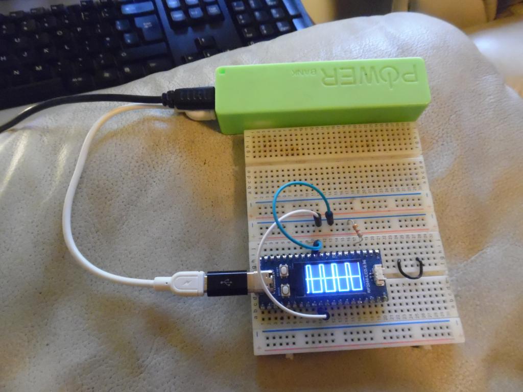

Posted: 03:28pm 19 Oct 2023
Because I hear the onboard supply is noisy and I used a-d I used a 5V and 3.3v lin reg supply and 3.3V enable grounded. that's it. dim probs.
Posted: 04:02pm 19 Oct 2023
Easy £1 poundland li-po rechargeable supply.

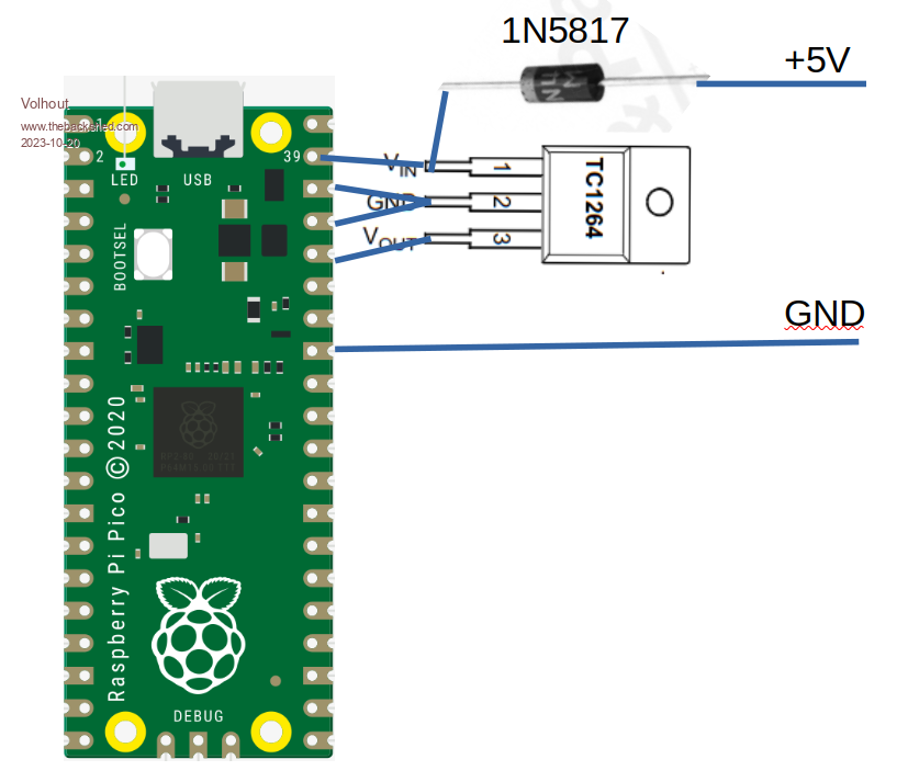

Posts: 6199
Posted: 06:00pm 19 Oct 2023
For your cheat sheet.....
The 3.3V linear power supply in it's simplest form.
Edited 2023-10-20 04:01 by Volhout
Posted: 06:14pm 19 Oct 2023
yes Volhout... and tantalum caps on input and out put
aFox
Joined: 28/02/2023
Posts: 110
Posted: 08:12pm 19 Oct 2023
According to the data sheet only 1µF on the output side.
Theory praxis may different.
But the TC1264 is not widelyavailable.
The Raspberry Foundation suggest a NCP1117 aka LD1117 with two 10µF on both sides.
I think the cheat sheet needs a back cover.
Gregor

Posts: 9246
Posted: 09:10pm 19 Oct 2023
The 1117 pinout is GND-OUT-IN so it doesn't fit that diagram. It's very easy to get though.
The LF33CV has the same pinout as the TC1264. Input cap can be as low as 100nF ad output cap 2uF - 10uF low ESR.
Edited 2023-10-20 07:43 by Mixtel90
