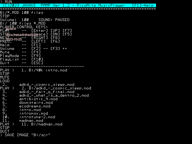

javavi
Joined: 01/10/2023
Location: Ukraine
Posts: 597
Posted: 04:02pm 24 Oct 2023
Hello Everybody!
Introducing my simple player
PMMP -- Pico Mite Music Player
for playing .MOD .WAV .FLAC files
PMMP.zip

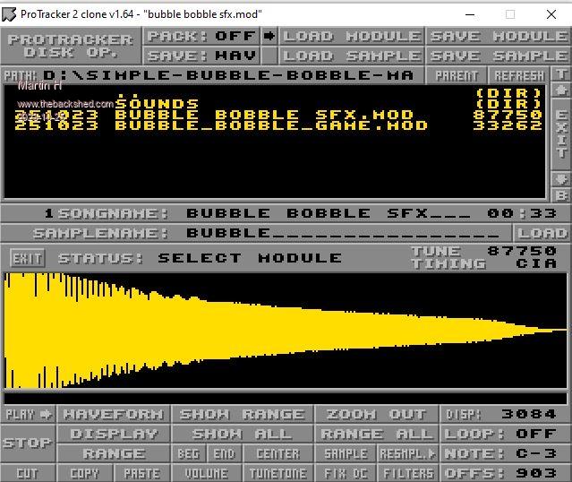

Martin H.
Joined: 04/06/2022
Posts: 1519
Posted: 05:56am 25 Oct 2023
LeoNicolas
try this little example:
I found a short "*.MOD" file. I also found the SFX Samples as 48KHz Stereo mp3 Files on Github and convertet them to 11025 8 Bit Mono using an Audio Editor (like audacity, Audition etc.)
Then used Protracker to add SoundFX starting at SampleNo 16 (&H10)
use this little Test Program
It plays the annoying Music as normal until you press ESC
Pressing keys 1 to 5 plays the SFX while the Music is playing
'Load modified MOD File
Play modfile "bubble bobble sfx.mod"
Bubble=16
BKill =17
Hurry=18
Jump=19
Damage=20
 k$=Inkey$
 Select Case k$
   Case "1"
     Play modsample Bubble,1
   Case "2"
     Play modsample BKill,1
   Case "3"
     Play modsample Hurry,1
   Case "4"
      Play modsample Jump,1
   Case "5"
      Play modsample Damage,1
Case Chr$(27)
Exit
End Select
Play stop
the modified Mod File
bubble bobble sfx.zip
I hope this makes the principle more understandable
have fun
cheers
Mart!n
