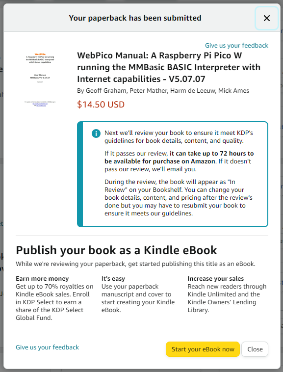

It would be absolutely wonderful to have an index. I've downloaded Word versions of the manuals, and started creating my own indices, but that's tedious work. I'd be happy to help. My process included developing a word-frequency list, knocking out the prepositions, adjectives, and adverbs, and starting from the remainder.
I also "gamed" the Amazon publishing-on-demand system by uploading a PDF version of the WebMite manual to their system so I could get a handy book format printed version.
To make this more useful as a bound volume, I modified the layout by setting left-page and right-page margins to provide more room for the binding, and page numbers at the bottom).
I put a copy of the fonts page on one of the inside covers, and pin-out diagram for the WebMite on the back cover.
As a "creator", I got a bound, printed review copy of the manual for a few dollars. (Previously, I'd paid big bucks to get a spiral-bound version from the local copy shop). Once the book arrived, I tabbed the "MM.Info", "Options", "Commands", and "Functions" sections for easy access.
It's still available on Amazon, but lost in the sea of other self-published stuff. It's only ever been printed once, for my "review" copy :-)
If that's of any interest, I'd be happy to do this again for our community.
Edited 2023-10-17 01:05 by NPHighview
Posted: 03:59pm 16 Oct 2023
  NPHighview said  I also "gamed" the Amazon publishing-on-demand system by uploading a PDF version of the WebMite manual to their system so I could get a handy book format printed version.
Good idea. Do you have a link? I searched for "WebMite Manual" and various other possibilities, but got nothing related. I don't want to buy that version, but might be interested in an edition for the upcoming manual.

Lizby - The book evidently got pulled by Amazon, perhaps because I listed Peter, Geoff, et. al as authors instead of me. Here's what I see:

  NPHighview said  The book ...
I've never had a printed copy of a MMBasic manual, but I'd spring for one at that price if updated for PicoMite 5.07.08.
