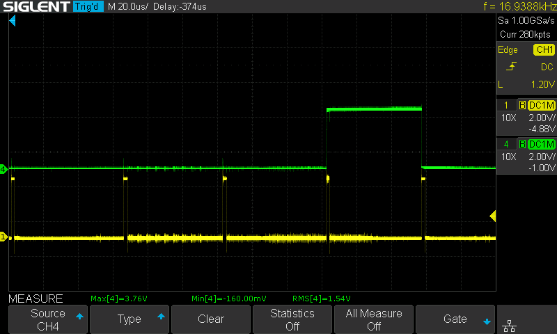

The main thing is to keep the clock 'high' time well below 60uS or the device will go into sleep mode.
Using a 2uS pulse is reliable and easy to do.
Yellow trace is the 2uS clock pulses and green is the data
