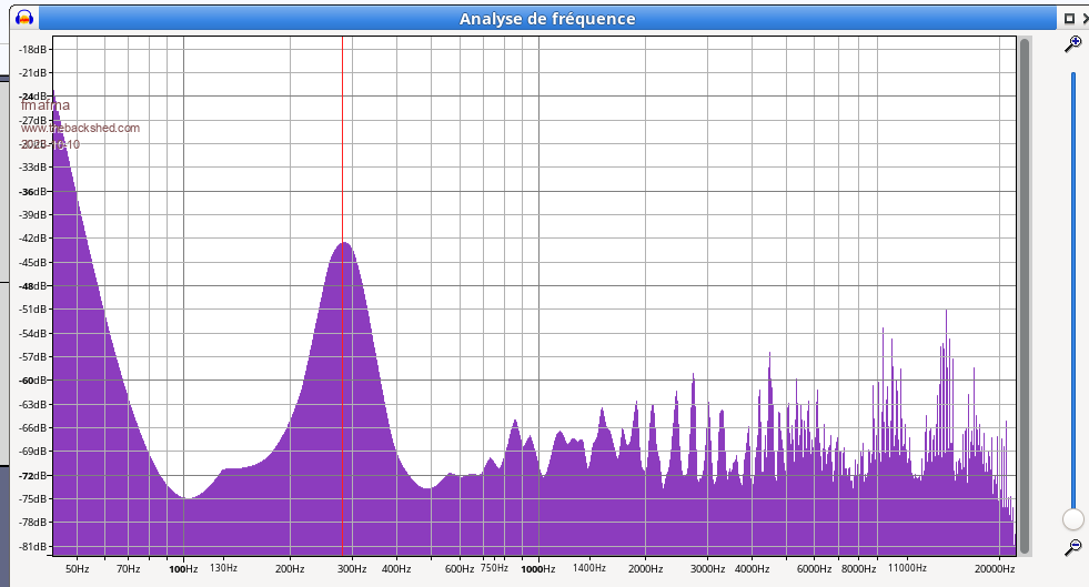

I still have a lot of troubles with the sound output. I connected my board to a little amplifier module based on a PAM8403, and I get horrible noises. I thought it was an issue with my power supply, but even powered from a PowerBank, I can ear the same noises.
I hooked up my board output to my PC sound card: here too, I can hear noises, but a little bit less. Here is a capture of the analyse from Audacity.
Any idea where the 280Hz noise (and all harmonics) can come from?
Frédéric
