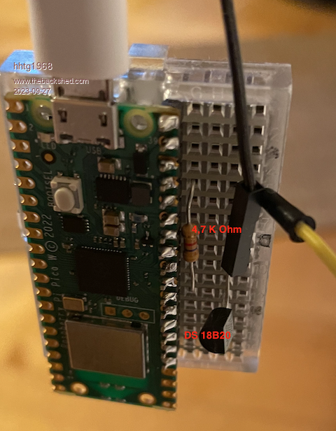

After visiting relatives in Norway for weeks i return to my picomites. Because of crashing my weather station (Raspberry Pi 3b) i started to create such a station with webmite.

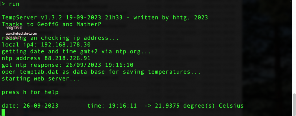

It based on the example in the manual by GeoffG. Its at the very beginning now. Main difference to the example is the "data base", a .dat file which is always growing (APPEND). Now i am coding a procedure to create a graphic from the data. The temperature is saved every hour.

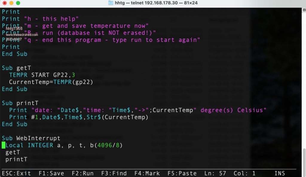

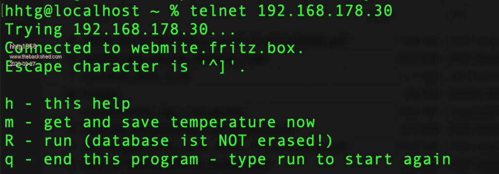

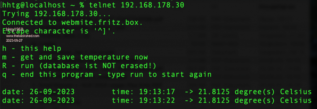

You can connect to the webmite via telnet, so you can edit the code on the fly. I took the DS 18b20 temperature sensor and a 4,7 K Ohm resistor. Because of programming in Basic it is so easy and fast.

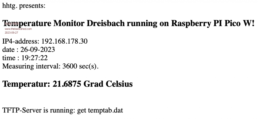

Next weekend i hope to complete the routine to create a png from the data of the last 24h or week in webServer on webmite.
Here i show via fotos the webmite itself, connecting via telnet, edit via telnet, running and writing data to the data base file.

and the web site...:
