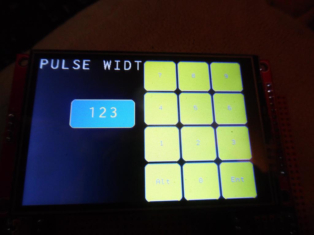

Hi. I was asked to code a simple square wave gen that did input number of pulses but the gui num box is baffling.
idea is input number of pulses then turn port on/off but can't figure gui num box though it shows numeric keypad. any help on what seems simple but not.

Posts: 6631
Posted: 08:58pm 21 Sep 2023
 OPTION EXPLICIT
 OPTION DEFAULT NONE
 DIM pulsewidth%,pulsecount%
 FONT 3
 CLS
 TEXT 0,0, "PULSE WIDTH="
 GUI NUMBERBOX #1, 80, 100, 140, 64, RGB(BLUE), RGB(YELLOW)
 CTRLVAL(#1) = 100
 DO
   pulsewidth%=CTRLVAL(#1)
   TEXT 0,0, "PULSE WIDTH="+STR$(pulsewidth%)
 LOOP
Posted: 09:30pm 21 Sep 2023
Ta Jim. it was TEXT 0,0, "PULSE WIDTH="+STR$(pulsewidth%).
I used a comma.
This is for a mate who can't code but is wanting a number of pulses to control a stepper motor controller for another old guys cnc.
