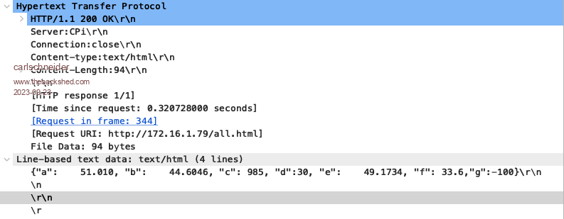

Maybe you need to consider the CRLF pair as well as whatever happens in your case. The below Wireshark capture for illustration reflecting all the CRLF as defined by HTTP.
In my case, although Safari was sending the correct Headers, understood and sniffed by Wireshark, the WEB Read on the WebMite was only getting the full Header into the buffer in about 1 in 13+ attempts. Most of the time the buffer only contained the JSON string payload being sent.
I decided that duplicating the analysis of the buffer to cater for JSON payload only and the 1 in occasionally that the full Headers arrived in the buffer wasn't worth it. If you only cater for the anomaly, when the correct Header gets through then it's a 404 situation.
But I needed it to work on my iPad as well as everywhere else, so I went with GET, which works reliably across all my browsers on all my devices.
