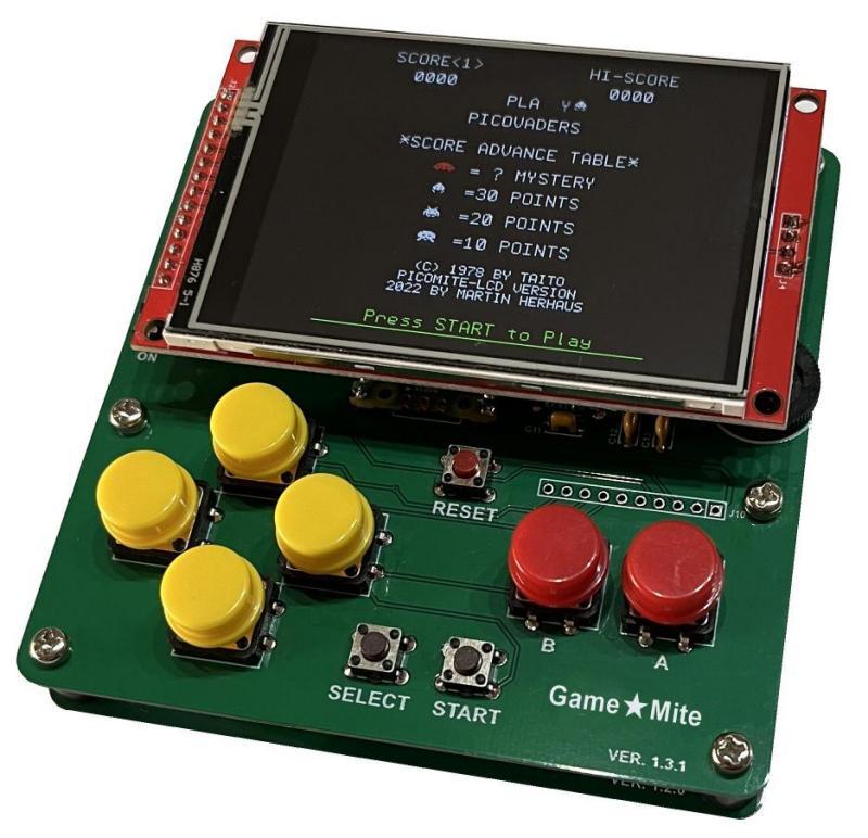

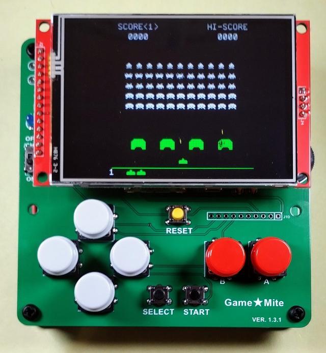

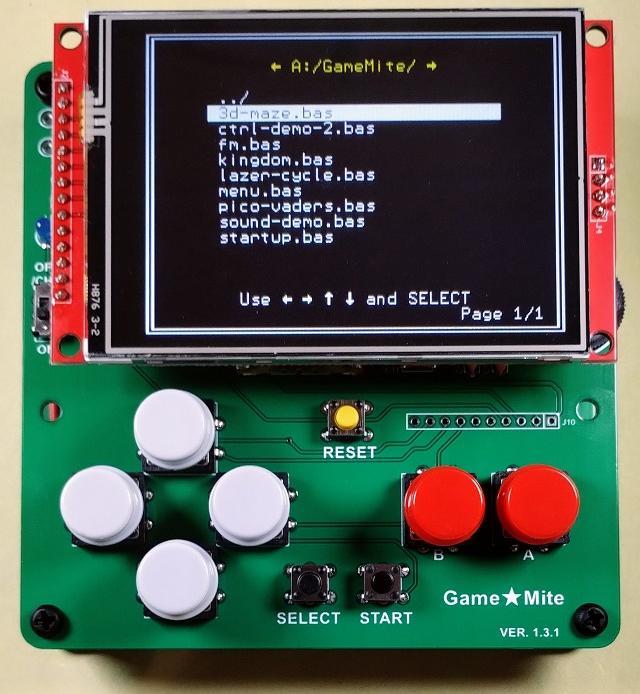

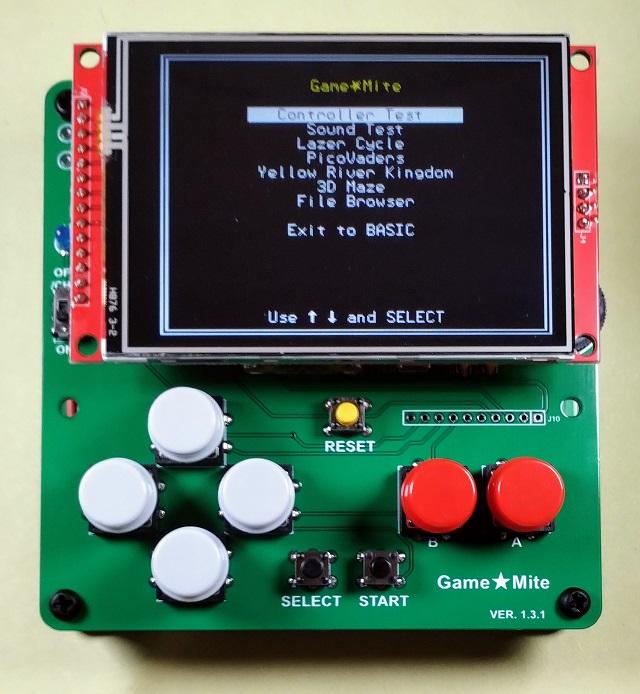

Hey folks,
It's been a journey but I'm pleased to announce the public release of the Game*Mite v1.0.0.
Features:
- Raspberry Pi Pico Microcontroller
- 320x240 ILI9341 SPI TFT display + integrated SD card reader
- NES style game controller (very clicky)
- Mono audio via PWM capable of playing 4 notes simultaneously
- 3v7 LiPo battery with charging and protection circuit
- MMBasic programming language
Links:
   GitHub
   User Manual & Build Instructions
   Gerbers
   Previous thread about the prototype
Acknowledgements:
- Mick Gulovsen (@bigmik) for his many, many hours work on the PCB, writing the early draft of the manual, reviewing the subsequent drafts and all the great advice and friendship.
- Bill McKinley (@Turbo46) for the BOM, reviewing the manual, helping me finally decide on an audio circuit, advice, friendship and keeping me and Mick on the straight and narrow.
- Geoff and Peter without whom all this fun would not be possible; Geoff also reviewed the manual.
- @Martin H, @Mixtel90, @Mozzie, @Volhout and several others here on TBS who helped me when I was wrangling the prototypes.
Apologies to anyone I've forgotten, speak up and take your share of the blame .
How do I get one?
That seems rash, are you sure?

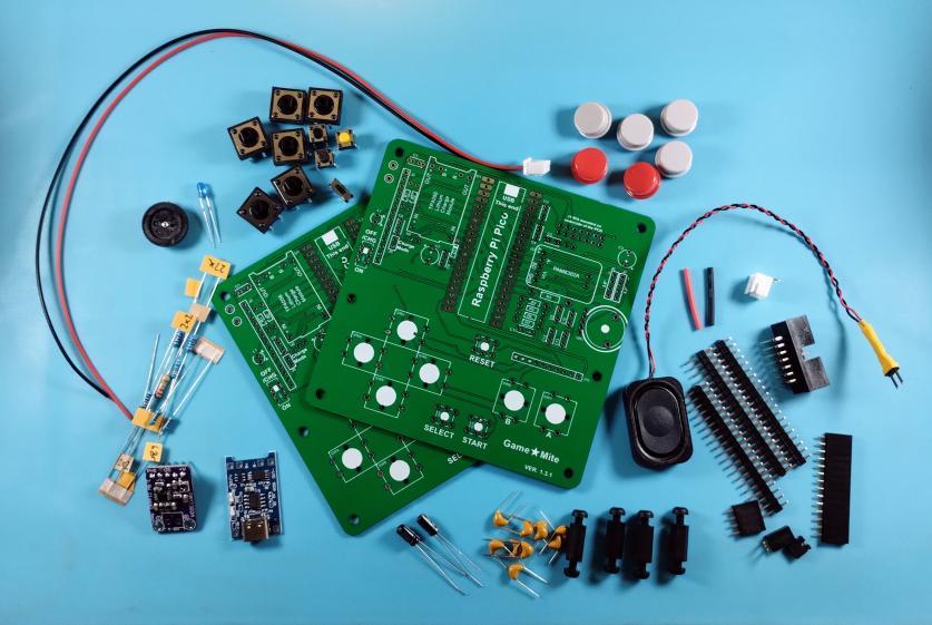

The Game*Mite is all open-source so everyone is welcome to build (and in the unlikely event, sell) them provided the various attributions are kept on the PCBs, User Manual, etc. and the PicoMite/MMBasic license is respected.
For convenience I can sell partial kits (without Pico, TFT or battery) directly to UK shedders at 20 UKP + P&P.
For anyone outside the UK I will have to sell via eBay to deal with taxes and similar red-tape. Unless I find myself making a loss due to additional fees these will still nominally be 20 UKP + P&P but I understand eBay will add destination appropriate taxes, etc. when you get to the checkout so probably not worthwhile.
Please note my kits include the light-grey (not yellow) and red key-caps and four (not six) sets of black nylon (not steel) spacers and screws.
As an alternative for our antipodean members @bigmik will be selling limited kits consisting of the PCB, PAM8302A, TP4056 and the "funny" volume control, I'll let him post separately about price.

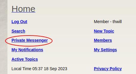

The forum has a "Private Messenger" facility, I'm user "thwill":

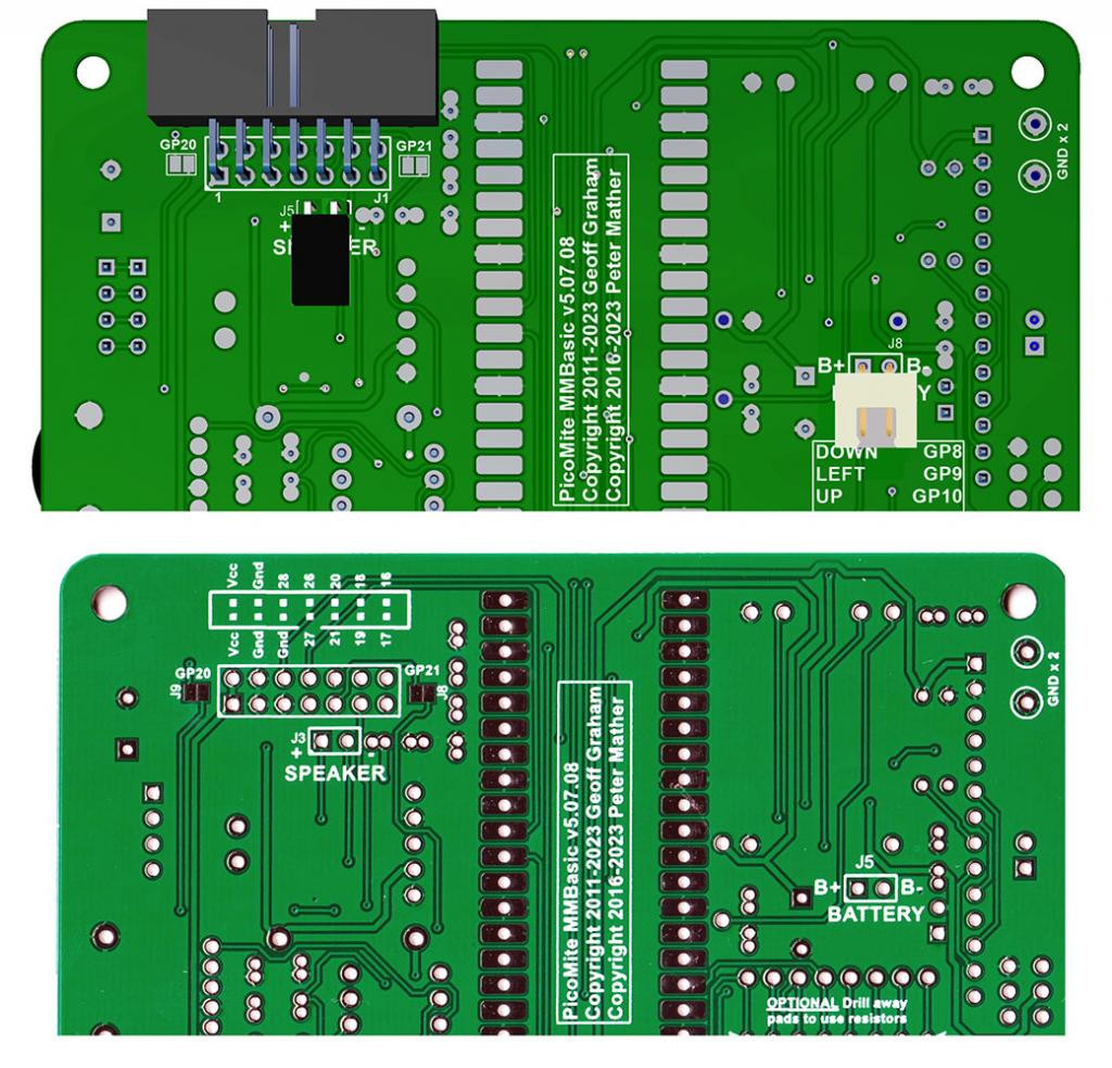

  Andrew_G said  . could there be more comment on J1 and how it might be used?
J1 is a 7x2 right-angle boxed male header bringing out all the unused GPIO: GP16-19, GP26-28. There are also solder jumpers to route GP20-21 to this header if you don't need the onboard audio. It also has 3xGND and 2xVCC (3v3), note there isn't 5V anywhere on the board unless being powered by USB. These pins are (I believe) sufficient to allow access to a limited combination of ADC,I2C0,I2C1,RxTx0 or SPI0 (shared with display and SD card). I believe it could be used for the simple DSO code currently being developed y @NPHighview and others and for a 6-channel logic analyser (@Volhout) though in the latter case you have to sacrifice or re-route the audio to other pins. We could have made more I/O available by copying the NES controller design and using a shift-register and additional pull-up resistors with the buttons, but we sacrificed that in the name of reduced complexity / component count.

More on that 'wasted' board
  Andrew_G said  rather than 'wasting' a PCB for the base how about a dimensioned pic for a sheet of say acrylic etc?
  thwill said  I'm sure @bigmik can oblige. Though at less than 1 GBP per PCB I'm not sure it's waste using one as the backplate, especially since it is printed with useful information about OPTIONS and pin allocation.
In the manual, bigmik has described a clever method using the extra board when soldering the male headers used for mounting the modules. The extra board is worth it just for that.

Also the expansion header has the text for the Pin out under where the header sits (as there was no other suitable place to fit that text) and by using a 2nd PCB that text is visible as shown in this mockup.

Posted: 09:35am 20 Sep 2023
Hi folks,
In response to a query received by PM here is a (not very good) photo of what one of my kits includes (note the second PCB is for use as a back-plate, it may not be of the latest version). Note also that the contents of Mick's full kit may differ.
