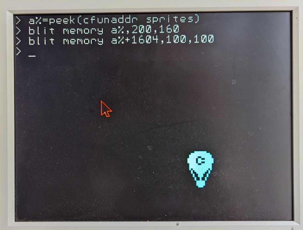

Set the const separatesubs% to 1 to get an individual csub for each sprite file
Set to 0 to have all sprite files converted into a single CSub
Output is to the console but just change the print #0 lines to print #2 and open a file to get output to a file.
The program deals with the colour conversions, the correct endianness, handles comments in the sprite file, deals with short or long lines in the sprite file, and reports the offsets for easy use
'program to convert all the sprite files in a directory to a CSUB

This is an update to the program that will also compress the CSUB. This will be supported by a new command BLIT COMPRESSED address%, x%, y% [,col]
'program to convert all the sprite files in a directory to a compressed CSUB
