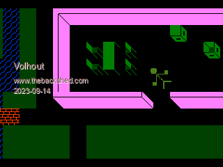

All,
Have spend 1 evening in toying around with my idea's about a basic implementation of PETSCII ROBOTS on the picomite VGA. This is VERY inmature. Just a scrolling landscape dynamically created from a world map.
No animations yet (opening doors, AI robots), just a player walking the map.
Some tiles (sprites) are based on commodore PET artwork, some are plain trials using color (with mixed success...pink...auch!!).
I will update the status in this thread.
P.S. the "player" is pasted in since SAVE IMAGE will save the active layer only. And player and world map are in different layers.
P.P.S. Thanks to Martin.H who's sprite editor (SPRED version 102) is very usefull.

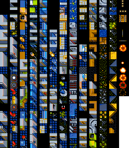

  Martin H. said  Nice look
but, if you are allready use Sprites, how abut using them in Color ..
Like a mix between the C128 and the Amiga Version.?
You can find the Amiga source (As an inspiration for your own sprites)
on GitHub
Hi Martin,
I have taken the short route to getting some tiles. Create them myself from the youtube video on PETSCII ROBOTS part 1 and your character set.
When the game is funrther ahead, me, or you, or any volunteer can create a marvelous tiles set....

Posted: 01:41pm 14 Sep 2023

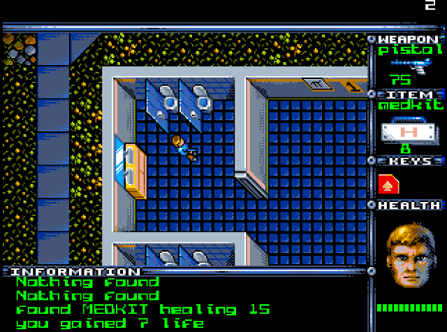

  Volhout said
Hi Martin,

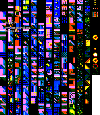

The Tiles on Amiga
and here, how the Tiles could look in the 16 Pico Colors...
not so ugly at all
Edited 2023-09-14 23:42 by Martin H.

Joined: 04/06/2022
Posts: 1573
Posted: 02:01pm 14 Sep 2023
  Volhout said  The pico has memory for roughly half the tiles the amiga has.
But we may not need to since robots and player (and maybe explosions) are on a different layer. So I do not need a player on tarmac, a player on carpet, a player on grass etc...
Layer "F" (the framebuffer) can hold 130 tiles (24x24).
Using the F layer cost you another 36k of Memory
Maybe better buffer the Tiles on A: as it is much faster than the SD Card B:.
If you now map the score and health display to a 64x240 area on the edge only on the layer, you can temporarily save 14 tiles you need on the N screen below without them becoming visible.
--edit--
You can also consider halving the resolution and reducing the size of the tiles from 32x32 to 16x16 the Space under the Layer would last for 60 Tiles
Edited 2023-09-15 00:17 by Martin H.
