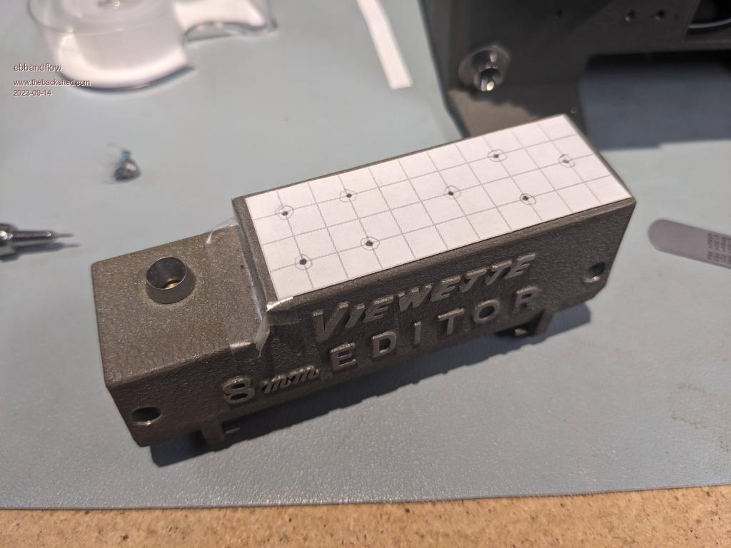

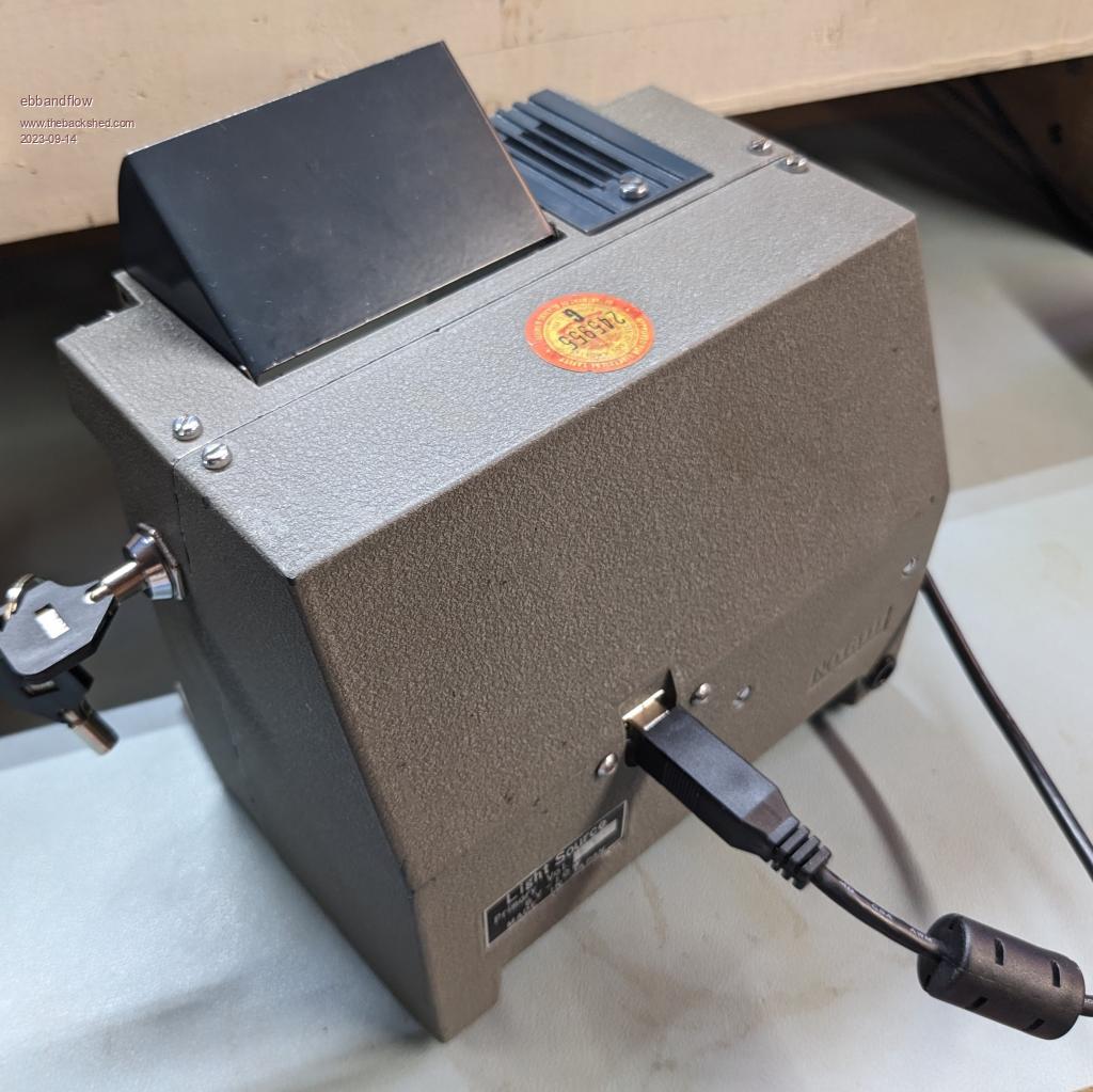

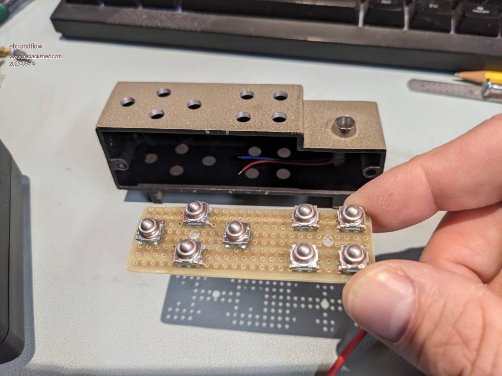

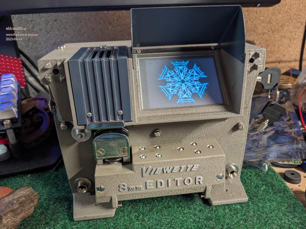

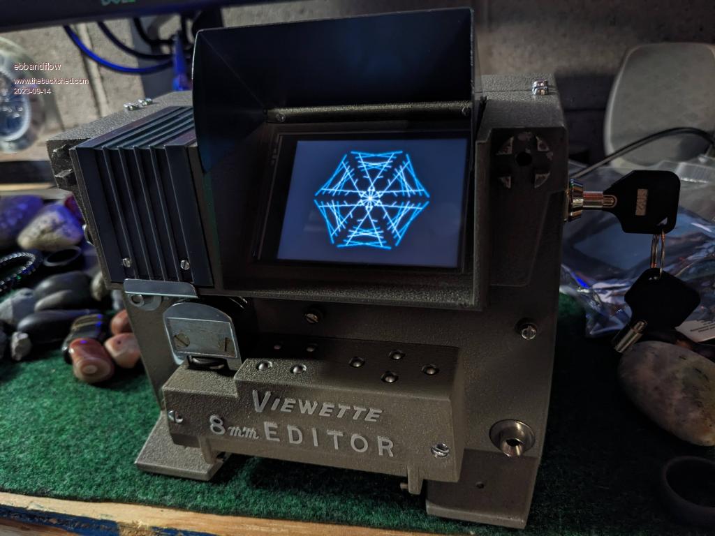

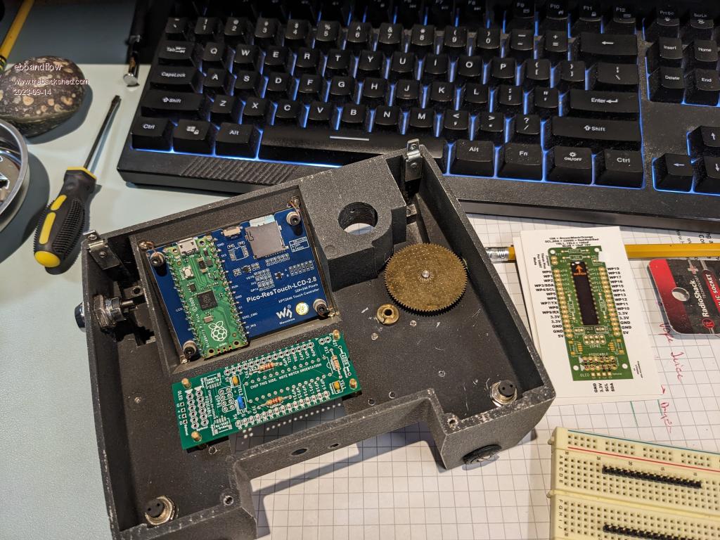

New here & wanted to share a picomite project I'm working on. It's a little 8mm film editor/viewer that is being repurposed into a tiny picomite 'computer'. A WaveShare 2.8 screen fit snugly behind the lightly frosted glass. The touch layer was removed from the screen along with the touch controller chip itself to avoid issues and recover a few pins. I found the perfect short micro USB to USB A panel mount cable for connection to terraterm but I hope to connect a ps/2 keyboard directly in the future. There are a couple panel mount LED locations, a keyed switch, and a red laser mounted inside, but not yet connected. The 8 buttons are wired to a 'Serial Wombat' as a expander - got the pico and wombat talking over I2C yesterday and called it a night. After further reading here and in the manual I wonder if I may swap the wombat for a second pico... We'll see!
Have a lot more ideas brewing but for now I'm in love with drawing random snowflakes and playing polar snake during my downtime. Many thanks for all the hard work & great stuff here.

Excellent project, and a nice way to reuse an old film editor!
Waveshare produce some really interesting and affordable boards like the one you are using there.  Those are currently only US$20, which is a really good deal for what they have packed onto it! LINK...
Keep us all updated on progress and on any other projects you dream up.

Oh, really nice, James.   That editor's made a really nice project case.
Welcome to the MMBasic world of antiques and curios - and that's only the inhabitants.

Nice !!!
The pico will also support sound, so you could even add a speaker.
When you record a sound of a running projector, you can even play that as a WAV or FLAC file... To accompany the snow flakes...
Adding the film wheels on arms would make it really complete, but increases the size significantly...
